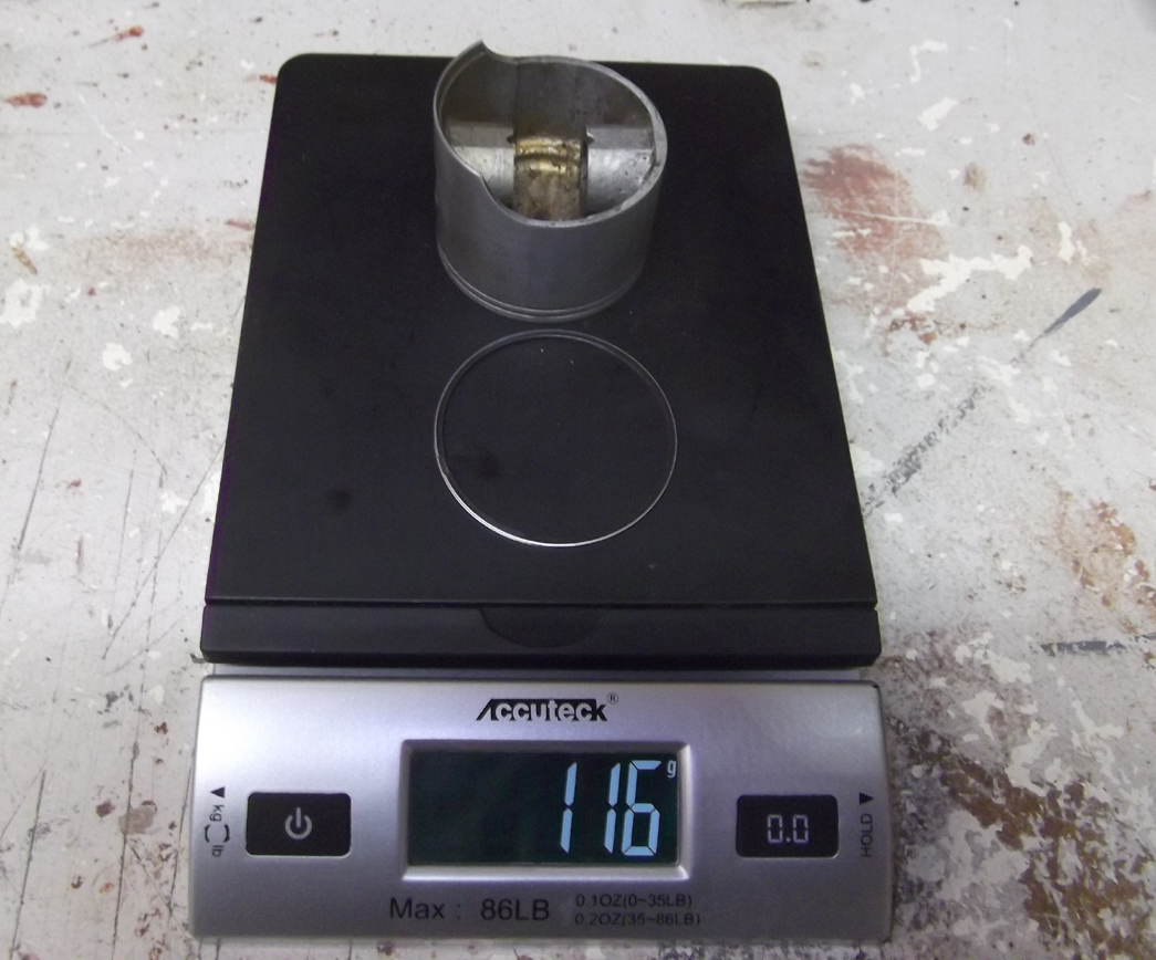

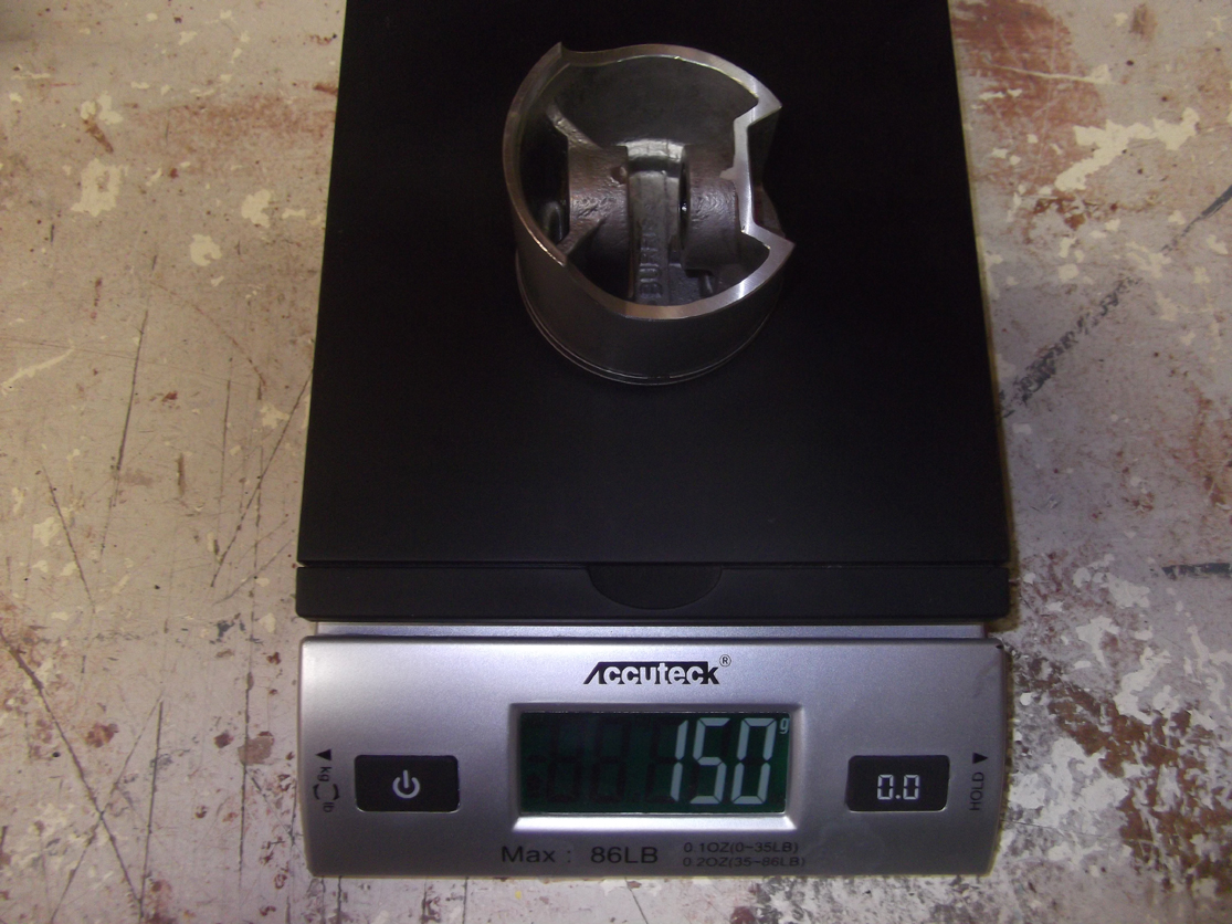

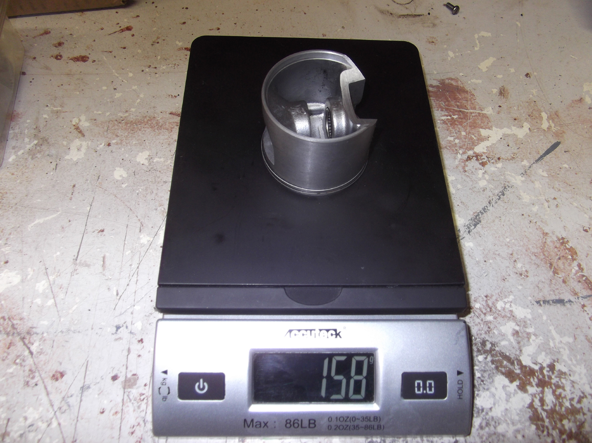

I started on the .068" over 101 today:
Also weighed out some oversize kart pistons (with rings but not a wrist pin):
First, Burris .068" over 101AA style "Quicktime" type piston and rings:
Second up: .050" over Wiseco Mc-101 "Classic" piston and rings:
Third up, just for comparison sake - Standard McCulloch SP-125 piston with new standard rings:
Awesome! That’s a lot of difference in weight, I noticed on my oversized Burris pistons that the the inside casting is the same dimensions as a stock bore and the piston skirts just get thinker for the oversized pistons, that weigh adds up. Weisco still dose the on some of there forged pistons.

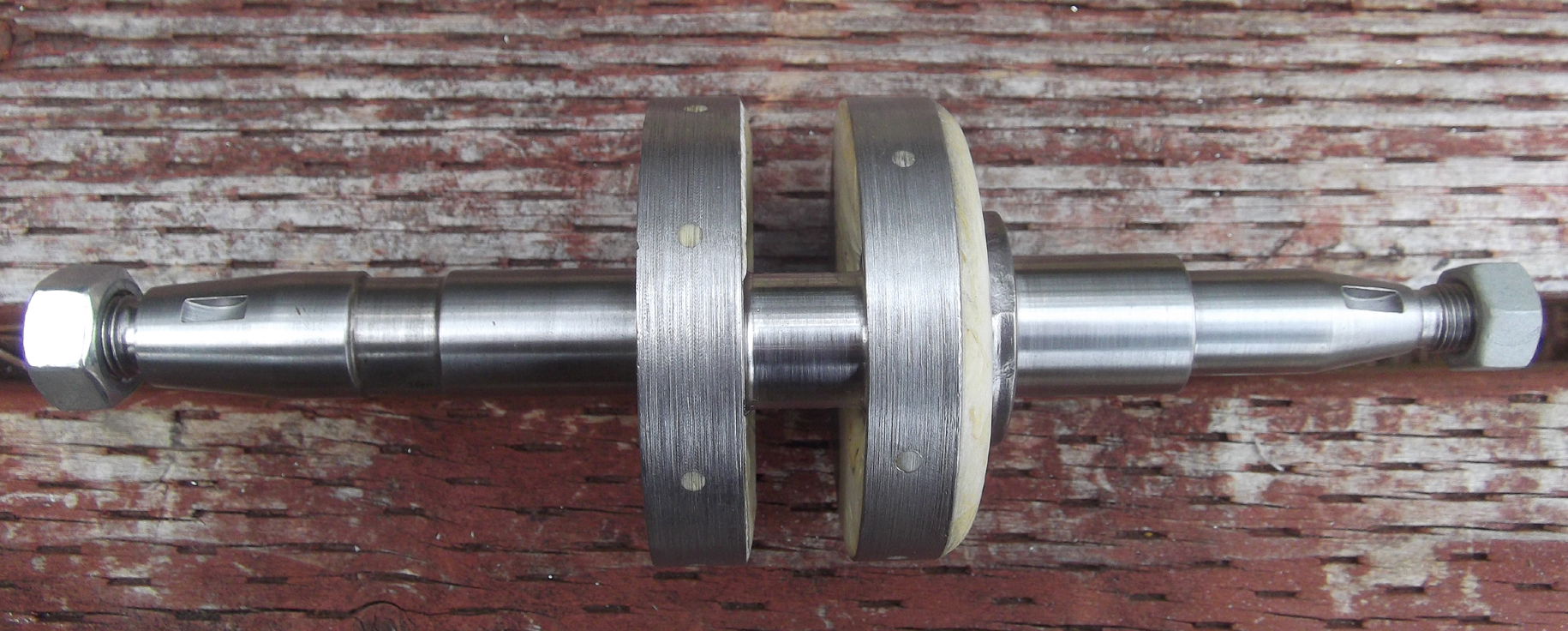

I still think the pistons made by McCulloch back in the day are some of the best looking pistons I've seen. Even the pistons for the smaller saws were manufactured to a very high degree of precision.
Years ago I mike-ed out some SP-80/81 pistons I got in a lot of NOS parts and there was virtually no variance among several pistons in the same letter sizing groups.

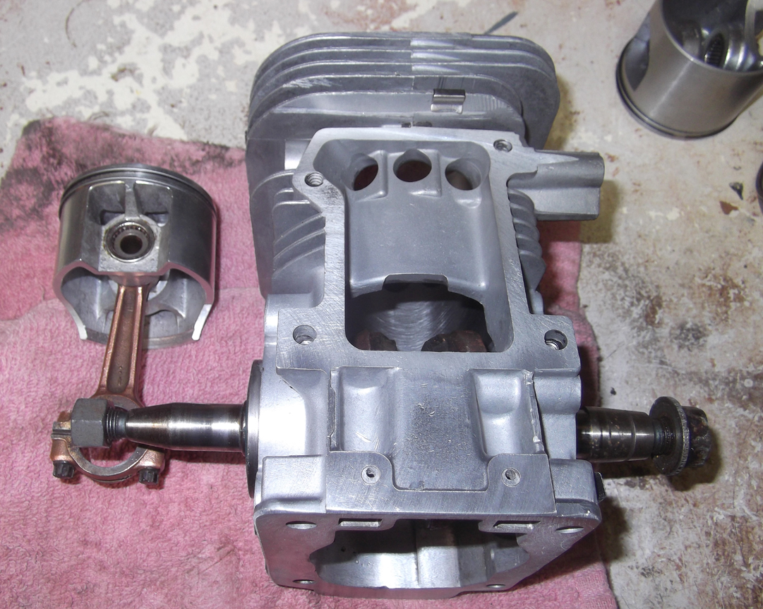

I clearances the 795 stuffer, it now fits without any contact, without a gasket. It didn’t take much, a little of the top an bottom and radius the sides of the main throw. CD70EF0A-CECF-410A-8315-7114777F5805.jpeg

Jacob, I had one of those. I sold it in a 101 chainsaw. It was built the same way. I got it from
Rich Dugan in a saw i bought from him years ago. Not sure if it made much difference.
Lee - I think it takes a particular carb-intake-stuffer-porting combo to really see the benefits. My plan with this is a Reed 246 vertical intake, a Go-Power six petal reed cage,
and an HL methanol carb. I have a GEM super stuffer for it as well.

If i remember right, That 101 i sold with the full circle crank didn't seem to have the power
other 101's i have. Not sure why.
