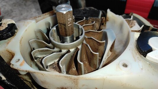

My lord all you need most times is a Flywheel Knocker. It is thread on the crankshaft end at the flywheel all the way and then backed off one to two turns. Then hit the end with a soft hammer to bump the flywheel off the taper. Usually only take one hit but several may be needed if someone over torqued the retaining nut or the key is sheared. Just don't go hog wild smacking the tool or you will damage the threads. And could use a couple of small wedges during this time to take the bearings play but not necessary most times.
In this case it would be threaded M8-1.00 and have an OD the same as the nut across the opposite corners in the rounded section. Basically you are using the weight of the flywheel and slight play in the bearings to bump it off. You then remove the tool and lift off the flywheel. If there is a stator underneath the flywheel then there will be some magnetic resistance.
The one pictured below is one of few I had made for various handheld two cycle engines. I had them made out stainless steel just because I don't like my tools rusting. The hex end is so the tool can be easily installed and removed.
Which is really no different than backing the nut off flush with the end of the crank and tapping it with a brass hammer, but Rube Goldberg got famous for a reason...
Well it does gives the user less of a chance damaging flywheel fins miss lick and especially in a recessed holes like this Stihl has. Not all of us have prefect aim. An example is the bathroom fixture that gets wet all over the place.
Note the external threads on the Stihl tool are 1.5mm thread pitch.

It's not about the crankshaft threads I'm talking about. Many service guys told me "do not hammer the crankshaft", and I asked why? They usually were telling me that the crankshaft isn't just a straight bar that goes through the machine's engine, it has it's "unique shape" and hitting one of the ends could potentially make bad things to the shape. Also they were saying something about crank seals. I already have a set of the tap pullers, but I need a set of those that you screw on the flywheel, to avoid hammering the crankshaft when I have that opportunity.
Here's one in action on my MS181:

Well most of us have enough common sense to know you don't go at it the proverb-able sledge hammer force. I use a 2# brass hammer. You use no more force than necessary and not get in big hurry. I have yet to damage a crank, bearing, or seal. Although seals are usually the reason I pull a flywheel. One reason is the amount play in the bearings and doesn't to jar something off a taper; unless, you're like one fool here used an impact on his mower engine flywheel not. He basically fused the flywheel to the crank. And even using the correct OEM I destroyed the crankshaft end. The flywheel had to come off no matter what as was hitting the screws of the crankcase.
Beside I would worry more about twisting those pressed together cranks on some of engines I have seen. Yes if you hit the ends with extreme force you can do some damage.
Now if you have the equipment and the time then making the puller that Stihl has is fine too besides it keep your ability sharpen up.
