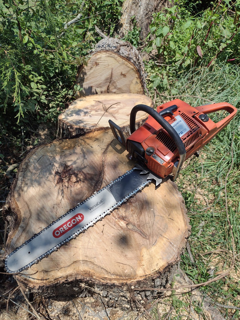

In the process of building a Shindaiwa 695 as a felling saw...
Parts should be here today.
Had to try the full wrap on another one & man I like it!
Not as wide as my 272xp full wrap!
Should be excellent for my needs.
Never ran one parts for a 757 I worked on were difficult to find.
Nice saw though.
