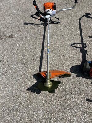

Went to get the 251 today. Price was $679 as opposed to 749 for the smaller fs240. They had 7 240s and this 1 251. I bought a brush blade, some .105line and a 6 pack to get extended warranty. The 251 had a 15% off coupon taped to it. Sale was good from 5/15 to 6/4. The cashier and lead cashier honored it without looking at the particulars. So got it for $577.00

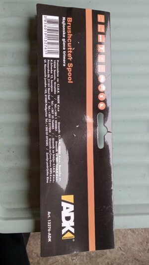

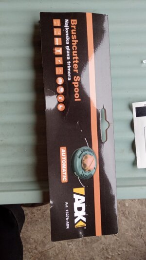

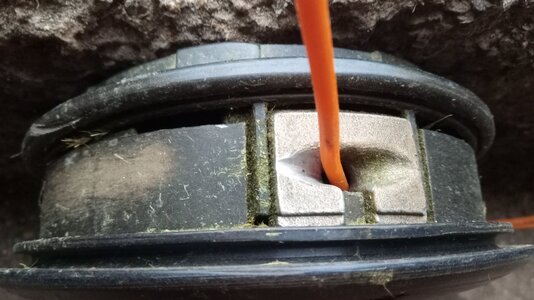

Can You get these over the pond?
They are rated for 3.0mm/.118" round line , but I am running 3.0mm/.118" square (flat to flat) in it which is more like 4.0mm/.157" corner to corner.
It is a push through & wind up bumper head and I am loving it.
They come with a single nut and it is M10x1.25mm, so You may have to adapt it to Your weedeater.
These are on sale for 10€ local to me, I got myself 4 of them.

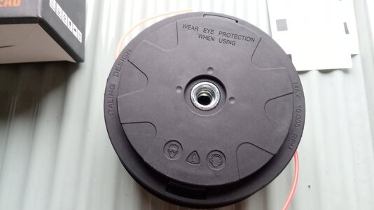

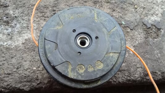

Watch out for cheap copies, apparently they pop open and fly apart - wrong word spelling in the plastics is a dead giveaway.

OEM
Fake
Hint "Italian" vs "Italing"
