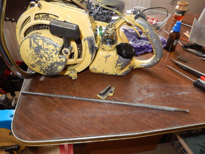

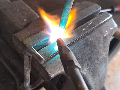

I found trying to start the RA without the footpeg extremely cumbersome. Somethimg must be done about it, so I got to my scrap metal box and found a 9 mm steel rod. Since the aperture for the footrest in the saw's starter holding clamps is about .25" I had to grind off the ends of the rod.
Then I fixed the rod in my vice and heated it pointedly with an acetylene torch and bent it into form.
The final footpeg mounted to the RA:
With it, it is very much more comfortable to start the saw, which BTW hasn't been successful yet. Still problems with the carb but that's for another post on another day.

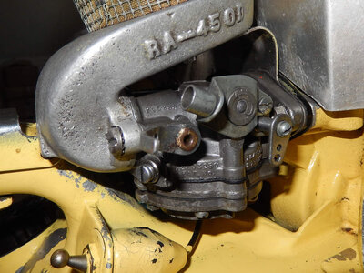

I have the RA running now, even cutting wood!
Had severe problems with the carb, I wasn't able to find a setting were the saw neither starved nor flooded but simply would run. Cleaning the carb I found the cone of L-needle being seriously corroded other than the very tip. That may or may not cause the problems, but I postponed that investigation since I then remembered the trick I used when the carb of my Pioneer 650 also prevented the saw from running: Swap the carb with a one from a DOLMAR CC. Venturi diameter and even the throttle linkage are identical, only the choke shaft I swapped form the Pioneer carb to have the handle on the right side beneath the carb's cover.
The not yet modified HL-99A from a Dolmar CC 109 built in for a test run.
Here I have swapped the choke shaft into the HL-99A.
With this setup the saw runs fine and cuts well.

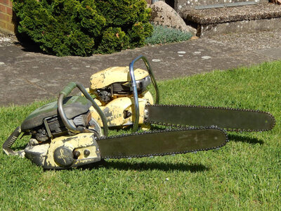

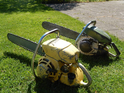

Finally here are my RA and my 650:

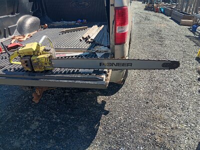

I picked this up at an estate sale for $25 cad , it was used as an ice saw .
I don't know what an ice saw is used for (cutting ice I guess, but what kind of ice ?)
but if it were to cut wood the bar IMHO looks much too long for the powerhead's output.
Good catch anyway even if it only were for the bar. What model is the powerhead? Looks a bit like 11-60
