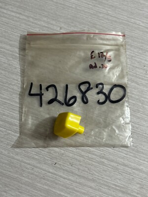

The picture he sent made it look like a yellow knob. Is it a pump? He doesn’t speak perfect english so we may have miscommunicated (?).

Yes the NU-17 has a primer pump,426815, that induces fuel straight into the carb throat ,rebuilding the pump is about impossible without the correct push diaphragm, the check valves are easy to make. I have rebuilt many of them throughout the years but finding diaphragms is the trick these days. The best alternative is to convert the primer setup to the easily available bubble primer bulbs like used on many smaller consumer saws, all that is needed is a squirt of fuel into the carb bore to get them started, same saw as the Pioneer 450-550. The yellow primer pump button, 426830, is usually busted off any old used saw so a NOS one would be tougher tracking one down.

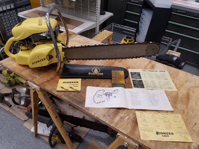

I have been talking to Av8or3 about a spare NU 17 I have but now I am not sure if I want to break it down and I am afraid it would cost a lot to send the whole saw over to EU, so lets keep looking in case someone else finds one while I make up my mind. Great that we can all chime in with info and help on situations like this. Don't want to leave him in the lurch. I was teaching a Platinum School at STIHL Inc. and a student brought me a pickup load of Pioneer stuff since he knew I collected from when he went to Gold School. His dad was a Pioneer distributor back in the '60s and now that he was nearing retirement he was afraid the next generation would toss it all out.

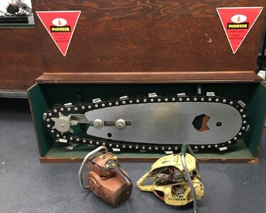

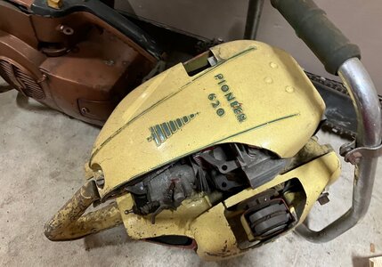

My friend also gave me a 620 cutaway:
Needs some cleaning...
He also gave me this:

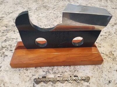

He told me it was used around 1965 at trade shows to show off the Pioneer bar and chain they were manufacturing. The chain is made from wood parts and will rotate around the bar. I have not seen another one posted anywhere or heard of one so it may be the only one in existence. I am proud to have it in my collection and thankful that he thought to give it to me.

Here is the part that started this discussion regarding the NU 17:
Slight crack but some epoxy on the underside would solve that. I checked out the other saw I have and the ignition components are present under the flywheel but the coil looks bad, all the insulation is cracking off of both of them. I will play around with an old 3 legged briggs coil and see if that might work. Compression is low so I pulled the muffler and this saw only has one ring so I will use the other one if I can make spark again.

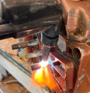

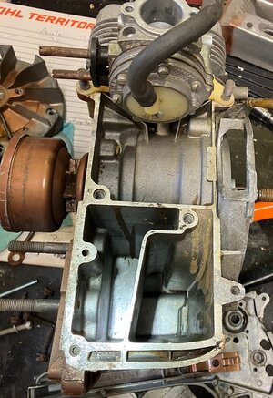

Help Please! NU 17 bar studs
The studs do not go through to the oil tank:
They will not unscrew with a stud grip tool, or vice grips, so I used the blue tipped crescent to warm one up:
Then let it heat soak a bit, and nothing. Three heat soak cycles and still nothing. Am I doing this wrong by trying to unscrew it?
I am trying to make one nice shelf queen, since both of these have bad coils and the primers are decayed to nothing. They have never cut wood, they were used as trainers in schools back in the '60s and have washers welded to all the 10-24 screws so I am replacing them as I go along. For some reason the studs were cut short on the block I want to keep, since it has compression and the other block with good studs has no rings on the piston. Never seen a stud that would not unscrew with heat before.

Nope, I think you will find the heads are square and actually cast in to the crankcase, non removable like several other IEL and Pioneer saws. Re threading was an option and Pioneer made available longer sleeved nuts to reach far enough on over the existing studs to catch on the non stripped threads closer to the bar pad.

That thought crossed my mind but then I thought, "nooo they wouldn't do that!"
This has been fun...
Thanks Basher
