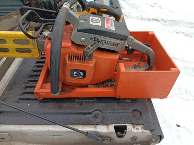

Anyone know anything about the Pioneer Farm Saw? Might pic this one up today from my neighbor.
I believe Pioneer after the P series they were more of a home owner saw rather than a professional series model like a Husky XP series then like the 460 rancher series, but they are good runners,

Got it, so this is not a “pro” saw.
I worked on a neighbors yellow one with the auto decomp, actually pretty nice running saw and I wouldn’t mind owning it if he ever gets rid of it
It looks to be in great shape, I am going to check it out today!

There's really nothing different than the pro saws about them. Different stater mechanism, maybe different porting? But they're every bit "Pro" style construction. Most similar to the Pioneer P41. Shares almost all parts in common except for flywheel/starter. I know that Farmsaws were even used in the logging industry as company-provided saws. 65-ish CC's. Some (although a bit of a stretch) even came from the factory with a 28" bar. Things that go wrong on them: Reed cage can crack, causing air leaks; Blue ignition coil can go bad, but can often be fixed by baking the coil; the top covers break; but most notably, the starter pawl gets rounded out. Very cool starter design, which engages decomp valve when starting. But also a pain in the butt to find parts for. I have an extra starter pawl sitting around.

Well I got the new part for the recoil and installed it. Got it started and after a few mins of smoking and burning off all of the old gunk in t he carb and cylinder, it ran great. I didn’t cut with it but I ran it for a good 5-7 mins and it cleaned up and has good throttle response, great saw!
