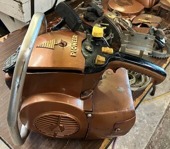

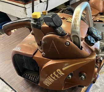

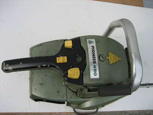

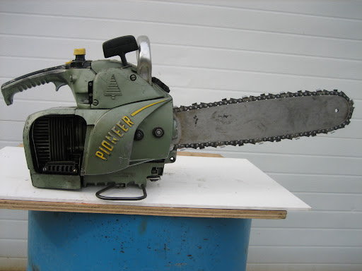

Well Basher, the NU 17 saga ends with it kicking my butt. As I went further into these two saws to try to make one good one things just started looking worse and worse. As I said before, they were used in training schools which is hard on them, with different people tearing them down and trying to put them back, so lots of parts were missing, gaskets not there, and the one with compression but the cut off bar studs turned out to have one con rod bolt and the bearings were a rusted chunk. I am surprised it turned at all, I guess because only one bolt and it wasn't tight. Both coils were bad and both primers were deteriorated beyond recognition. So I picked the best parts from both and built a shelf queen to represent the model in the collection.

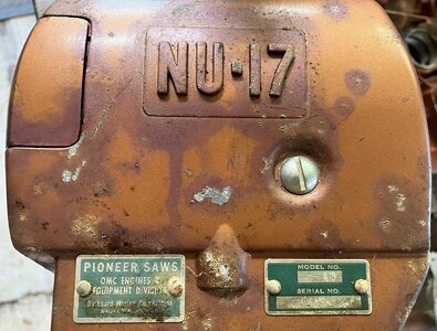

This rear cover has tags and the serial is 1541.

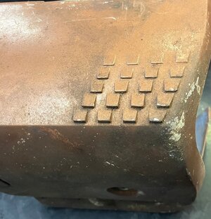

This cover has no tags and it doesn't have NU 17 cast in the back and does have this pattern on the top, where the one I used is smooth.

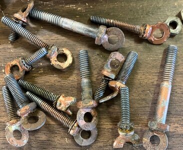

These are the fasteners I replaced. So it has been a fun learning process and reminded me of how difficult these old saws are to work on, with fat fingers trying to start screws and nuts in tight places, and part fitment being challenging in some spots. I can say the same about old STIHL models and Homelites and others. When I think about the first time I tore down a MS 500i where the engineers actually put a lot of effort into making it easy for service, I marvel at how far we have come in this trade.

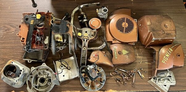

Here is what is left over:
Piston and cylinder could be used but no rings are present. Crankcase no good due to studs being cut off. Coil is bad and the black handle top with non-functional primer is going to Jim. Clutch is missing but sprocket is good. I don't think either of these saws ever cut wood, so the carb is NOS and all the metal parts are in good condition other than paint being perfect.

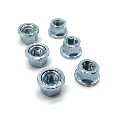

For any of you guys running pioneers or any saw requiring a 3/8 bar nut. And wanting to swap out any raggedy stock nuts I recommend a grade 8 aftermarket with the free spinning washer.
If you contact this guy you, he will sell bulk or you can find local at a good nut and bolt place. Around 2$ a nut. 🥜
Good zinc plate coating and sturdy. Similar can be found for most all these saws in different sizes.

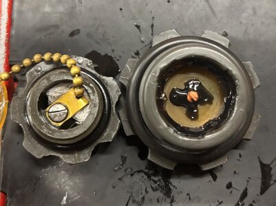

An attempt to fix leaky Pioneer oil and gas caps:
On the gas cap, I removed the inner plastic vent valve holder, drilled the center hole, and inserted a Homelite style duck bill vent into it. Then I epoxied the other holes closed, and epoxied the retainer back into the cap. We’ll see how it does.
On the oil cap, I removed the screw holding the cap retainer, stuffed some gauze into the area above the vent hole, and put the cap retainer back on, smooshing the gauze firmly into place.
