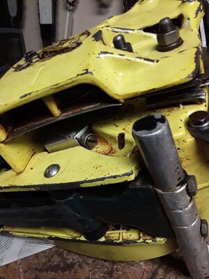

Hello gents! I have a 2 part question.1) How do I adjust the oiler on a pioneer Farmsaw? 2) Does anyone have an air filter cover they'd be willing to sell for a Farmsaw?

Hello gents! I have a 2 part question.1) How do I adjust the oiler on a pioneer Farmsaw? 2) Does anyone have an air filter cover they'd P series oiler adjust screw.jpgbe willing to sell for a Farmsaw?
The screw is in the middle of the pic. The pic is a P41 but the screw is in the same place as the Farmsaw
Sorry Tim,my eyesight is in the toilet.I can't make heads or tails of that pic.Also,I need to know which way to turn the screw to increase or decrease oil flow.Thanks!
Turn the saw on it's side, clutch side up. On the clutch side of the saw case, Look behind the butt end of the front handle. The is a slot head screw in a channel at a 45 degree angle.
Turn the screw clockwise gently until it stops. That's the lowest the oiler will flow . Normal would be 3/4 of a turn clockwise to start with. It should flow a lot of oil.

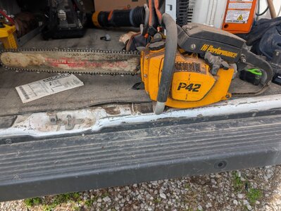

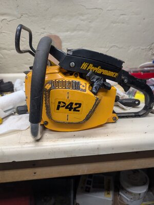

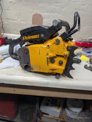

A before and after of a P42 I picked up recently. I haven't tried to start it yet, I just went over it real quick to find any obvious defects. Besides a broken clutch spring, it looks pretty good. Would the P42 come with an 18" bar factory? I want to buy a new bar and would like to get one that would've been common to the saw. 1000003236.jpg1000003282.jpg1000003283.jpg

I'd put a 24"on it , I believe it actually came from factory with a 16" bar ,
