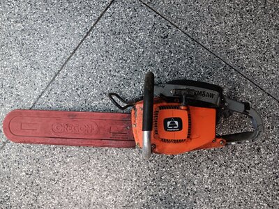

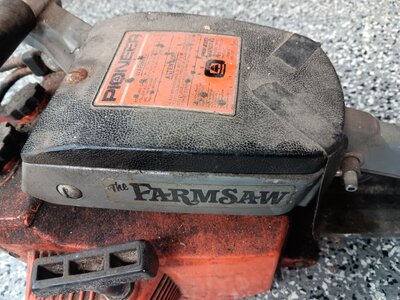

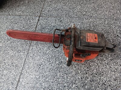

I was given this Pioneer Farmsaw but can't find any identification tags on it to know what model or size it is. Any info is appreciated.

The model is "Farmsaw" and its displacement is 66cc. Decent saw with prestolite coil issues and a fragile starter. Make sure the auto decomp under the starter is working.
Production year is likely around 1981.
Attached is a repair manual and owner's manual
