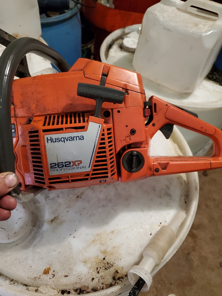

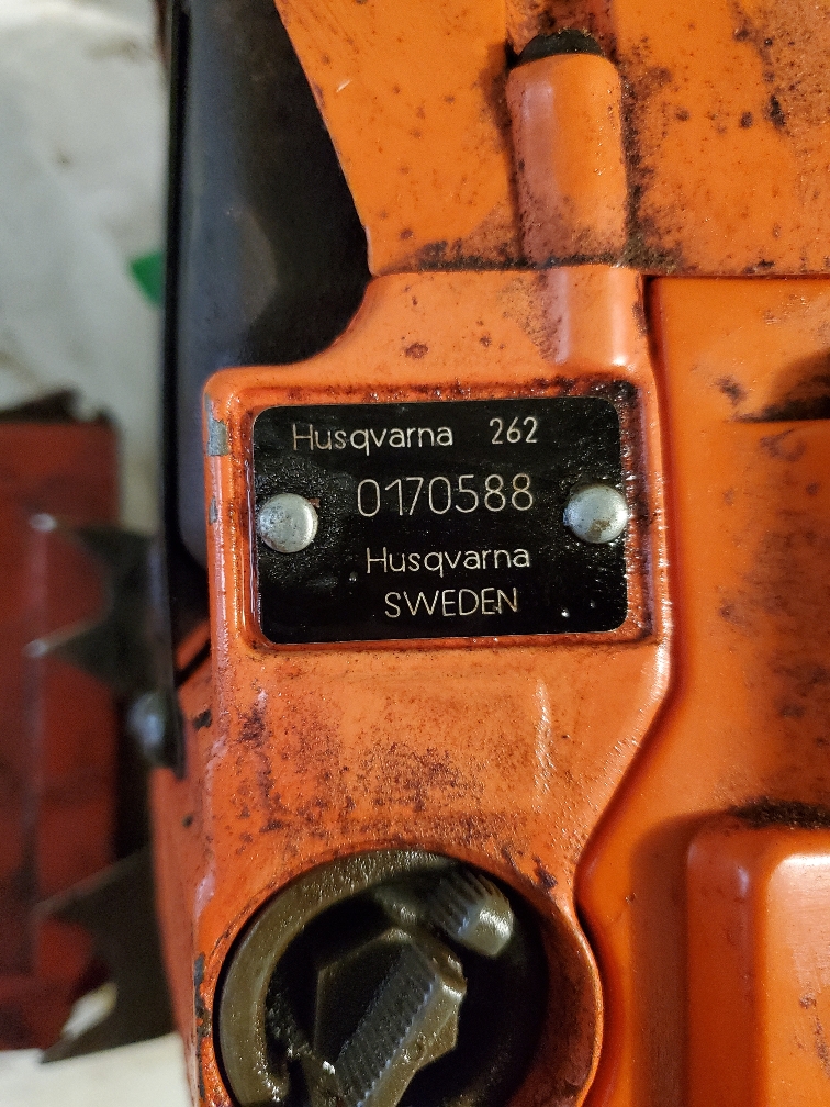

Can someone help me identify the year on this 262xp. It has the pocket in the tank handle. I see it has the 87 carb. Any guess as to what cylinder it has?
Thanks

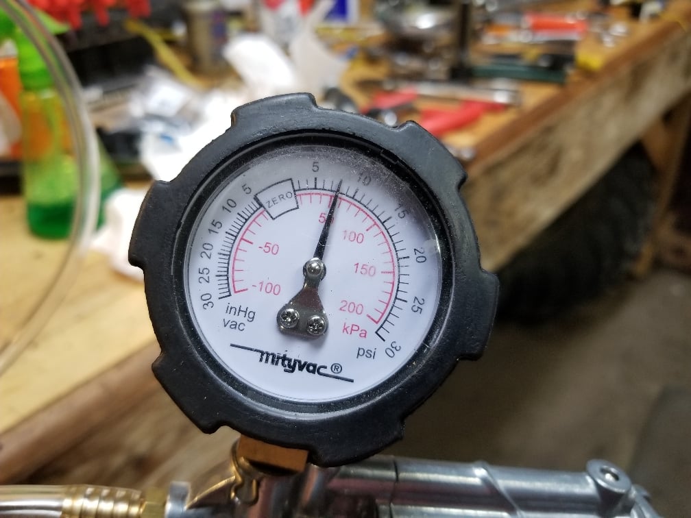

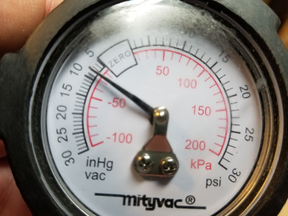

Different bushing,
I went to local hardware and found rubber plugs , made the av buffers and worked out perfectly.
P & V the saw a few minutes ago,
Could not be more happy with the test , held both sides of test 5 minutes.
This is going to make a great saw .
Waiting on a tank vent and it will be ready to finish
