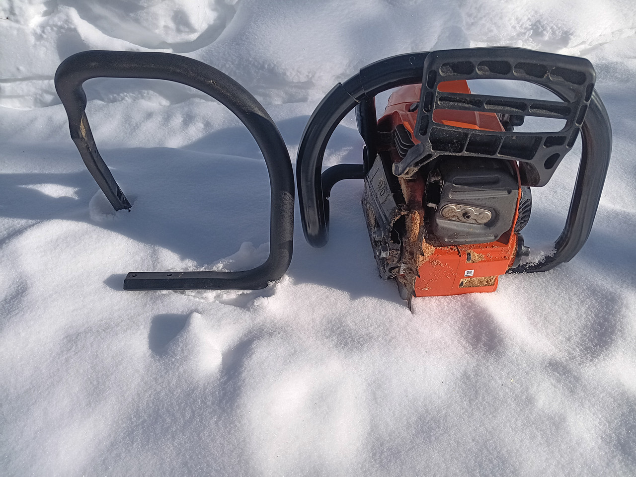

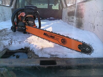

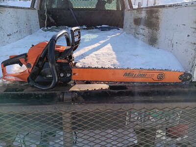

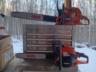

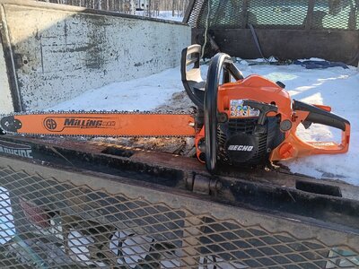

Getting closer. The narrow kerf bars arrived from Australia. They're essentially the 3/8 lp milling bars with a .325 narrow kerf 10 tooth nose. GB just released .325 narrow kerf 12 tooth noses and will try both noses bore cutting. 12 tooth part # is GB12PTN
Its a light bar/chain combo, half lb lighter than 24" versacut/84 dl 3/8 EXL combo.
95 drive links a little too long. Waiting on presets to shorten the chains.

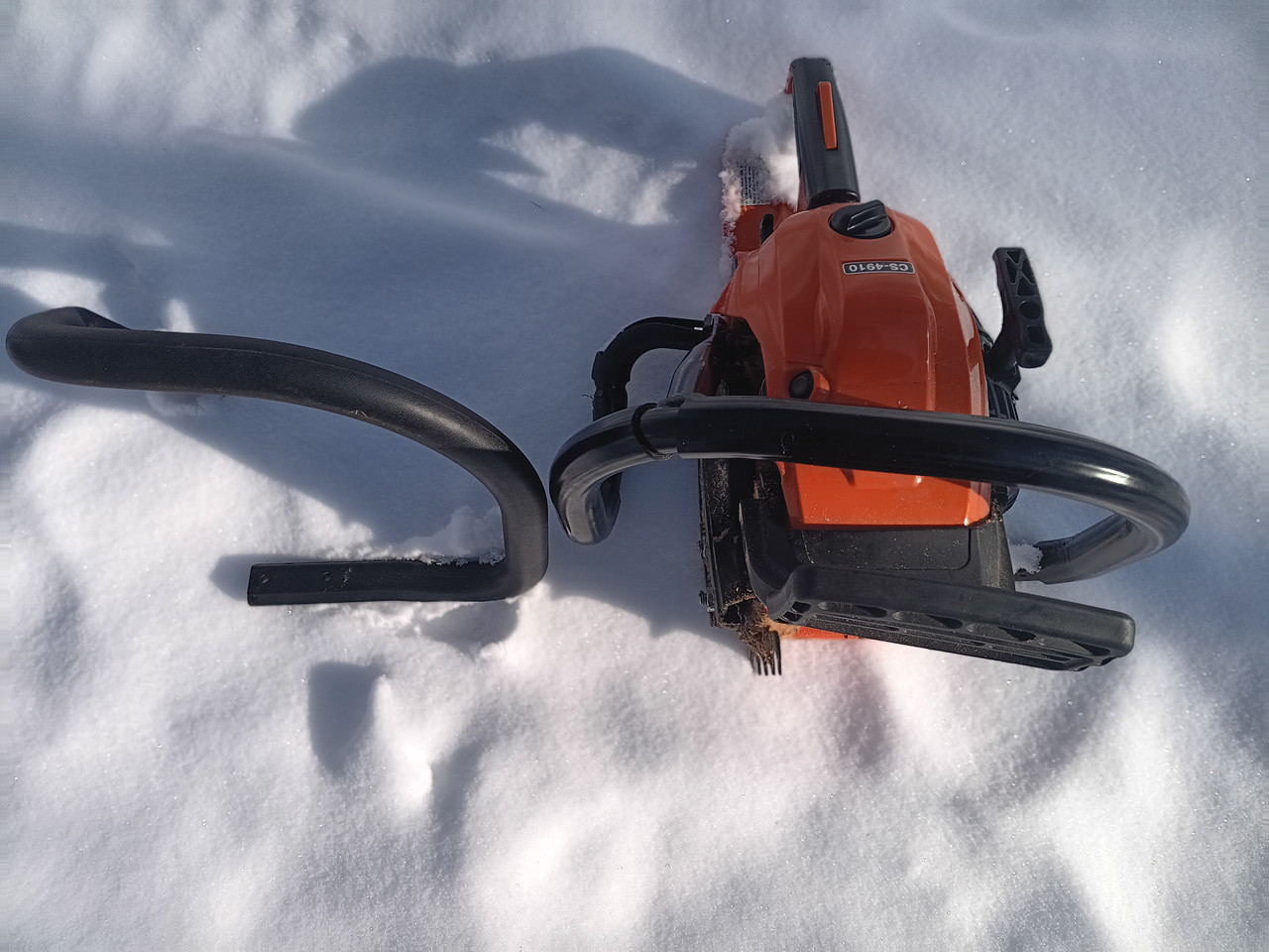

Ill spell it out for the unoriginal youtubers if they want to copy my sht for their content:
Breakdown of cost:
$340 new in box 4910 pho
$170 bar from outbushman.com.au
$35 chain from see saws run llc
$40 for the wrap handle. Wagner chainsaws
