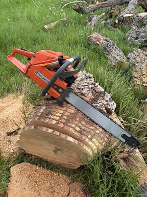

Ran the 2100 in wood today after fixing a few things. Almost all good. Hadn’t tried the manual oiler until now and found it was stuck. Hard. Auto oiler does the job though. Looks like it’s missing a pre filter or something. Any hints on freeing up the oiler? Where to find pre filter? image.jpg

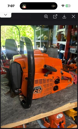

No bar studs, strange 'air filter', weird handles, extra holes in the case on the front and more...
Anybody seen anything like this before?
Looks like someone was using it to power something else, like a poor-man's generator.

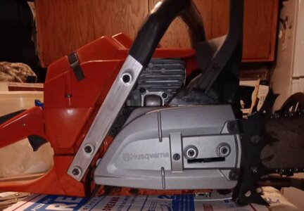

What's the chance 585/592 XP Clutch Cover fitting 365/372/565/572??
Yes those annoying captive nuts are seducing me.

I've got a brand new one if you want to try adapting it to something else, I'll trade it for a chain i can use or sell it for cheap

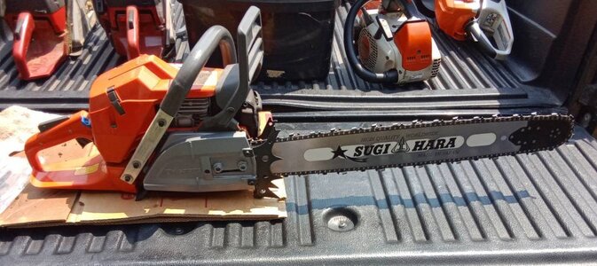

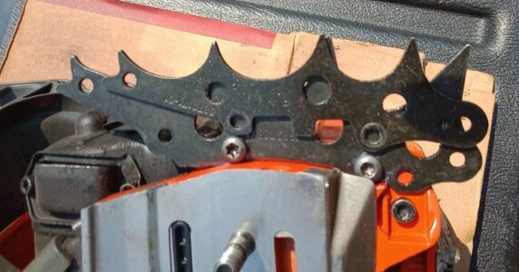

Thanks to redneckhillbilly can confirm 585/592 clutch covers with captive nuts will fit 365/372, (jred brothers) & 565/572 saws. 372xpg demo's nicely.
Fit the inner spike as best I could with what I had. Drilled using OEM 372 spike as a pattern and chain catcher holes matched up. Had to grind a little away to fit. Didn't get it perfect depth wise. The height matched great.
