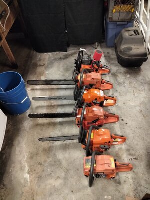

Got a family picture of the all of the Husqvarna's I have:
Front to back:
* 136 (dump find)
* 440 (well used store loaner saw)
* 55 Rancher (dump find)
* 455 Rancher (customer returned to store - said "was a piece of junk")
* 272 XPG (dump find)
* 2100CD (dump find)
Front to back:
* 136 (dump find)
I'm going to the wrong damn landfill...

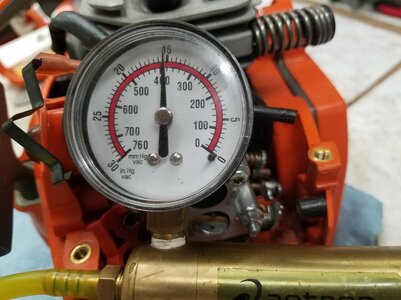

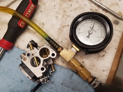

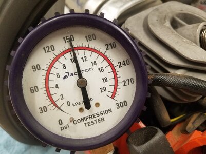

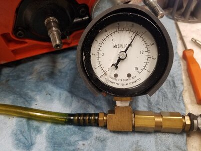

Husqvarna thread is not too active here but I will ask anyway...customer brought in a 240 that he only uses occasionally, as in once or twice a year. I went through it last year with fuel lines, fuel filter, carburetor kit and it worked fine for me but he says it dies after making a cut. He is using canned fuel and it looks and smells good.
I ran it until it was good and warm and tried snapping the throttle off after running WOT and sure enough it would die. I tried adjusting both H and L a bit leaner assuming it was too much fuel but it did not cure it completely.
I went through everything on the saw, compression is 150 PSI hot, crankcase holds pressure and vacuum just fine, carburetor holds 12 PSI, I can't get much more out of my squeeze bulb tester so I don't know where exactly it might pop off.
He needs it this weekend so I am sending it out the door but expect it will come back again. What else should I be looking for? FWIW, it always restarts in a pull or two if I put it in the fast idle position, reluctant to restart after dying with the throttle at idle.
I did look through the carburetor again, everything is clean, diaphragms are pliable, inlet screen is clean.
