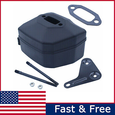

I purchased one a while back for several I’m building. They look really good for the price.
I've used the am 55 mufflers for a 266 I just port matched it
I don't know if all of them are as nice but it was extremely well made one of the best made mufflers i've seen on any saw.
I don't know why they make such crappy 268/272 mufflers i've had the bolt tubes break loose in very low hour saws.
