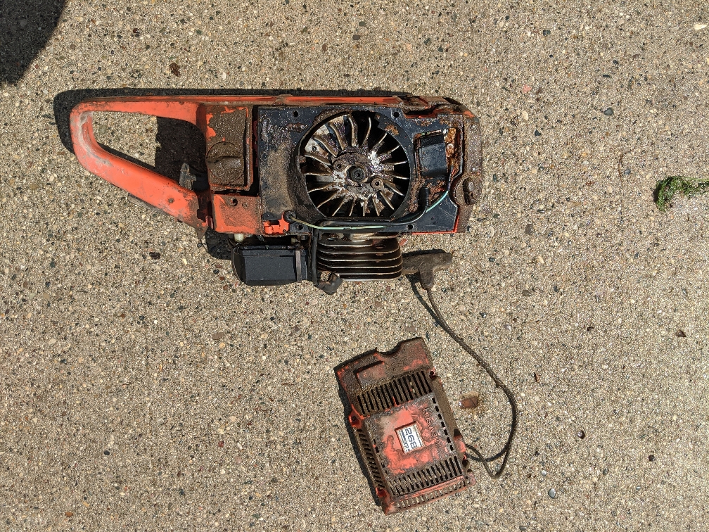

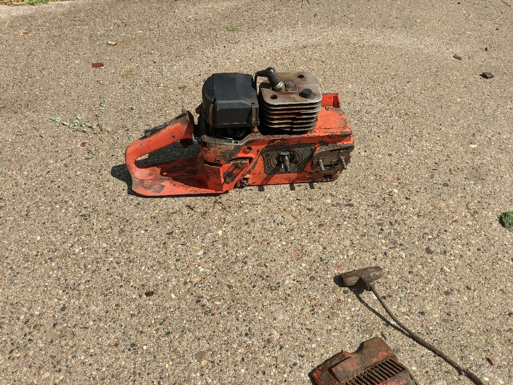

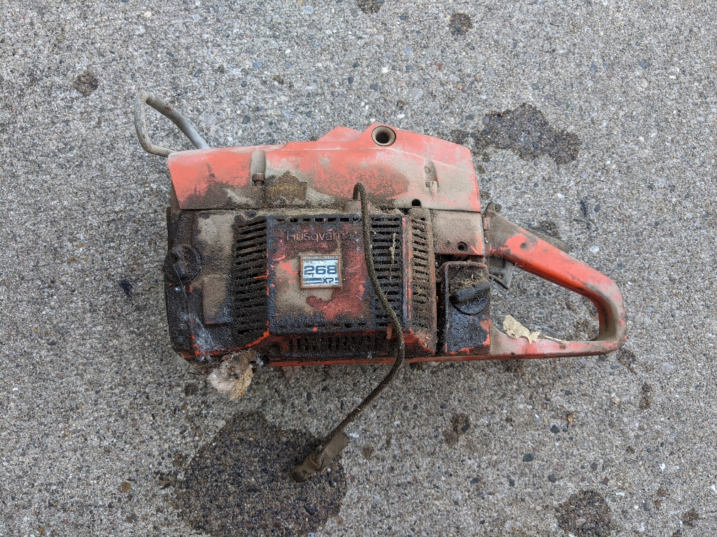

brad ruch
9:01 PM
1745
Aug 25, 2016
272
466
michigan
It's pretty dirty.and I need a top handle and top cover.the cover is really beat up.
Sent from my Pixel 2 XL using Tapatalk
9:01 PM
34,537
196,713
The am half wraps have held up for me
Running 24" bar's cutting hardwood
No bendy.
Used some am plastics no problems.

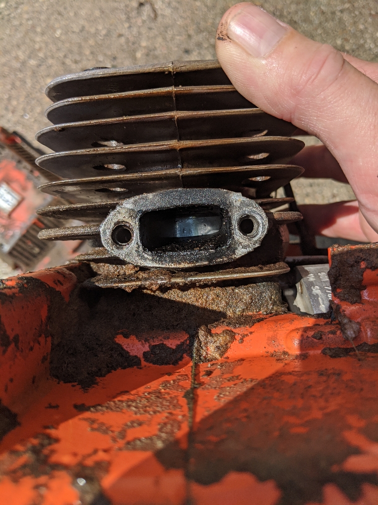

brad ruch
9:01 PM
1745
Aug 25, 2016
272
466
michigan
Tried the bathroom foam and just a garden hose sprayer.didnt to great not enough spray power.thinking I should take it down to the manual carwash and spray the heck out of it.piston looks pretty darn good.
brad ruch
9:01 PM
1745
Aug 25, 2016
272
466
michigan
I could use a clutch cover also.has a crack in it.

9:01 PM
34,537
196,713
Take the air deflector off before pressure
washing it
They're brittle.
