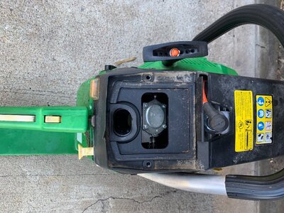

Hedgerow: What is the secret handshake to get the top cover off?
Got the usual three screws out but the end by the rear handle acts like it’s glued down.
Either it has an air leak or the carb is not passing fuel. 🤬
Comp is 160 and fat spark.
Gotta fold that intake boot in on itself then wiggle the *s-word out of it..
That cover seals into its base and is most likely just stuck..
It’s probably never been off.
