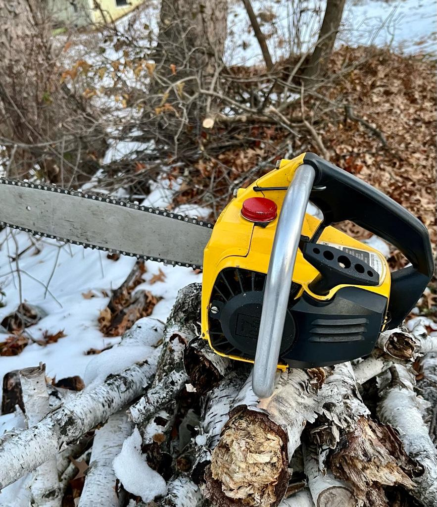

I just learned on this one. Steve’s advice is true. Everything on MiniMacs loads from the front including the throttle link. Make sure the oiler nipple is lined up along with the fuel line to the tanks before assembly. I think they’re easier than the little Homelites. Not much though!
