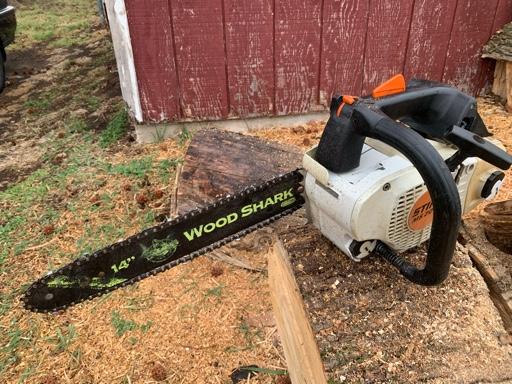

Once again I was forced to adapt a 14” Walmart Poulan bar to a small Stihl.
Drill an oiler hole in the bar edge. Dog hole is good to go.
Driver count is messed up tho. Poulan chain is 52. Needs to be 51. Normal Stihl is 50.
Cut with it anyway. Oiler works.

New model Stihl, the 201t Woodshark.
Be the first on your block to own one.
