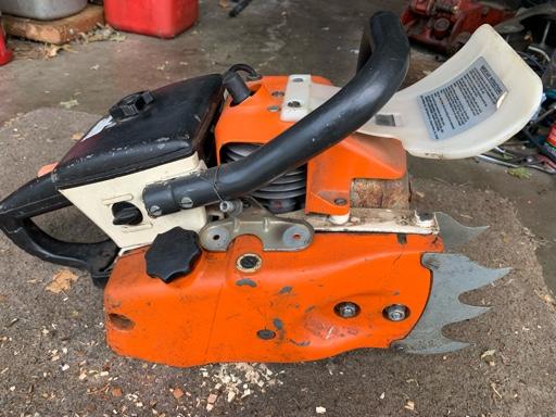

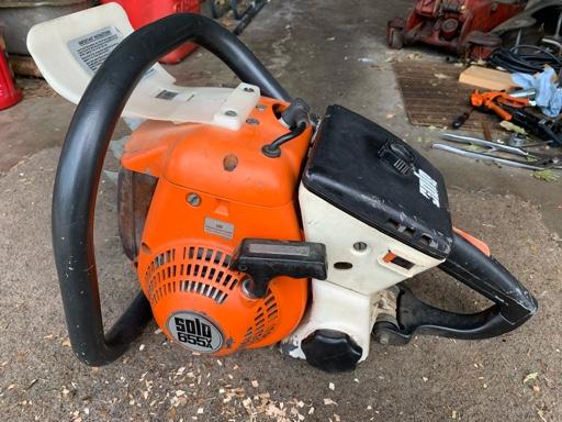

This should be interesting:
Recent evilbay purchase:
We have had the Solo a long time. March 2016. Bout time I did something with him.
It very closely resembles a Stihl S10.
120 psi and arc welder spark. Points mag [emoji106]
IIRC it needs seals for sure as it would only pop on a prime.
Things are about to change. [emoji1696]

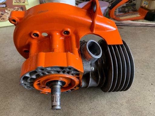

Morning midlanders!
Got the Solo half torn down. Many parts held together with lots of slotted head screws makes slow going. [emoji43]‍[emoji94]
The impulses line (Tygon, [emoji90]) was disconnected is why it wouldn’t run from the get go. [emoji2960]
67L36Driver
3:00 AM
596
9,674
41,654
Finished de constructing the Solo. [emoji106]
Gads, someone must have gotten kickbacks from the fastener supplier. [emoji2960]
Good news is all it needs is rings and crank seals.
Cylinder looks near pristine and piston has .0035” skirt clearance.
