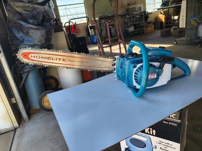

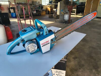

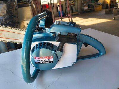

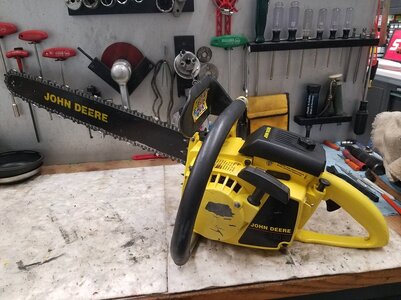

For now I decided to put it together as it is and keep it in the display. If I can find a good source for those seals I will acquire a few and get this saw back into working order. For now, it looks pretty good. We pulled that John Deere label off the damaged AF cover and put it on this one that came off the saw that donated the piston and cylinder for this project.
I did practice restoring the faded plastic from the damaged AF cover that came off the saw. Amazing what a little time with a heat gun will do.

That's an awesome John Deere, albeit a bit rough, I'm still looking for one. Generally the few I do are are always near mint.

I was about to ask how you improved the AF cover. That came out pretty nice!

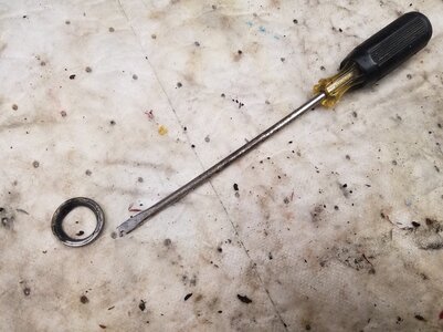

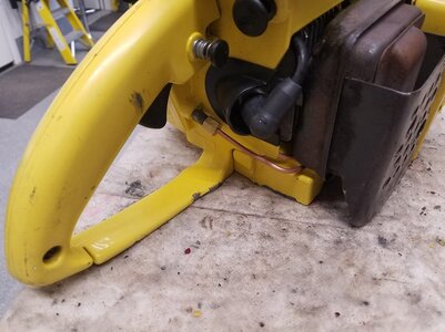

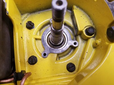

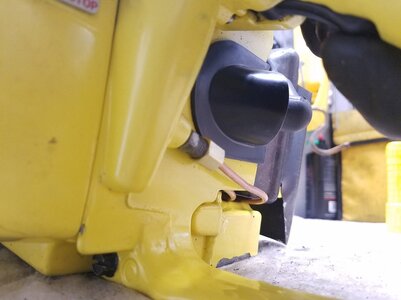

"58308" seals from LRB arrived this week. They are really 5/8x15/16 like 0609318TC that Tim noted but I was able to get the one installed on the PTO side relatively easily.
I used a screwdriver with a small notch to get under the lip and hook the metal body, then a tap with the hammer to pop it out.
It took a little work to get the lip over the step in the crankshaft, but I was able to get it on without popping off the spring. It also took a little effort to get the body of the seal pressed into the bore but some careful persuasion with a hammer and a deep socket the seal went in.
This is the old seal, as you can see it is a tight spot to work in down in the crankcase.

Some of the Homelites have that crankshaft step near the case make it a pain to get the seal over the step.
I wrap the shaft above the step with electrical tape even with the step diameter to make it much easier to get the seal on.

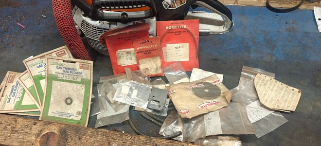

Anyone interested in this little pile of new old stock stuff I've had under a workbench for years?? It's free. I just hate to throw it away. First person to pm me their address and I'll get it sent out tomorrow.
