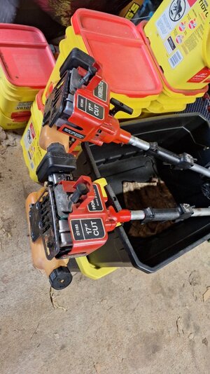

I've had 3 of these ST Homelites for about 5 years and finally got around to making them run. Muffler gut really helped.
Super simple to work on and used modern gear boxes on the heads with the echo style speed feed head. One has a 1987 stamp in the cover .

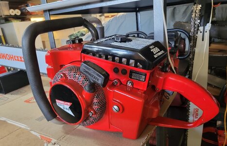

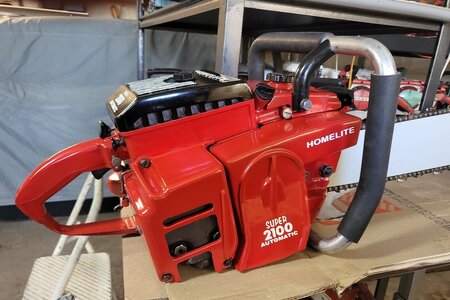

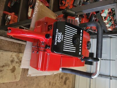

I've torn down the what I thought was the 2100 Super, but I'm not sure it is. Is there a tell tell indication between the 2100S and the super 2100? This one has a splined crank for the Clutch, and a thin ring piston.1000003436.jpg1000003437.jpg1000003435.jpg

I've torn down the what I thought was the 2100 Super, but I'm not sure it is. Is there a tell tell indication between the 2100S and the super 2100? This one has a splined crank for the Clutch, and a thin ring piston.View attachment 490659View attachment 490660View attachment 490661
The crank in both are the same, one of the few differences I've found is the Super 2100 was available with the 7/8" clutch, the 2100 and 2100s were not, only a 3'4" clutch. You can tell by the thickness of the clutch cover
