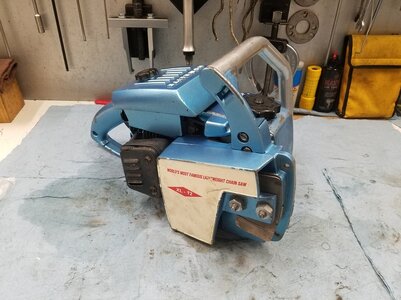

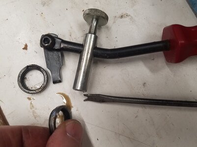

XL12 went through the shop this week, customer said hard to start and would not hold a tune. It only had 120 PSI compression and while it passed pressure test, vacuum failed. I was able to replace the crank seals, rebuilt the carburetor, replaced the fuel line & fuel filter, cleaned and gapped the points (or so I thought), replace the resistor plug with the proper CJ8. I was excited to hear it run but alas, not even a solid pop.
I removed the carburetor to see if perhaps there was an issue with the reed valve, gave it a tiny sip of fuel and it acted like a timing issue.
I removed the flywheel (again) and rechecked the points with a more appropriate width feeler gauge and low and behold the gap was well in excess of .020" when it should be 0.015". Reset the gap correctly and the saw ran flawlessly.

The Lisle tool is quite handy, but on a small seal like these I had to use the modified screwdriver first to create a little clearance for the hook on the puller.
They even offer replacement hooks for the ones that get bent, damaged, broken, or otherwise modified.

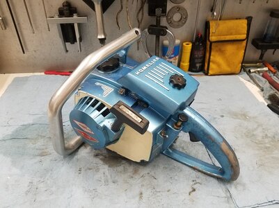

The paint on the old blue XL-12s seems to hold up pretty good. I've got one in similar condition and a first year Super without the thumb pumper.

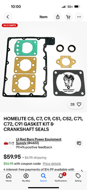

Here’s a kit with reed gaskets and everything

Thanks again, I'd seen that LRB kit. Interestingly enough, the carb rebuild kit I bought off ebay (Marine Specialties or something similar) had the reed gaskets & carb gaskets in addition to ALL the carb parts. Even sent o-rings for the Hi/Lo needles in case the packings were too far gone, prob the best carb kit I've ever purchased!
I did find that LRB has a set of only the crank seals on ebay as well, might try to find x-refs to SKF.
