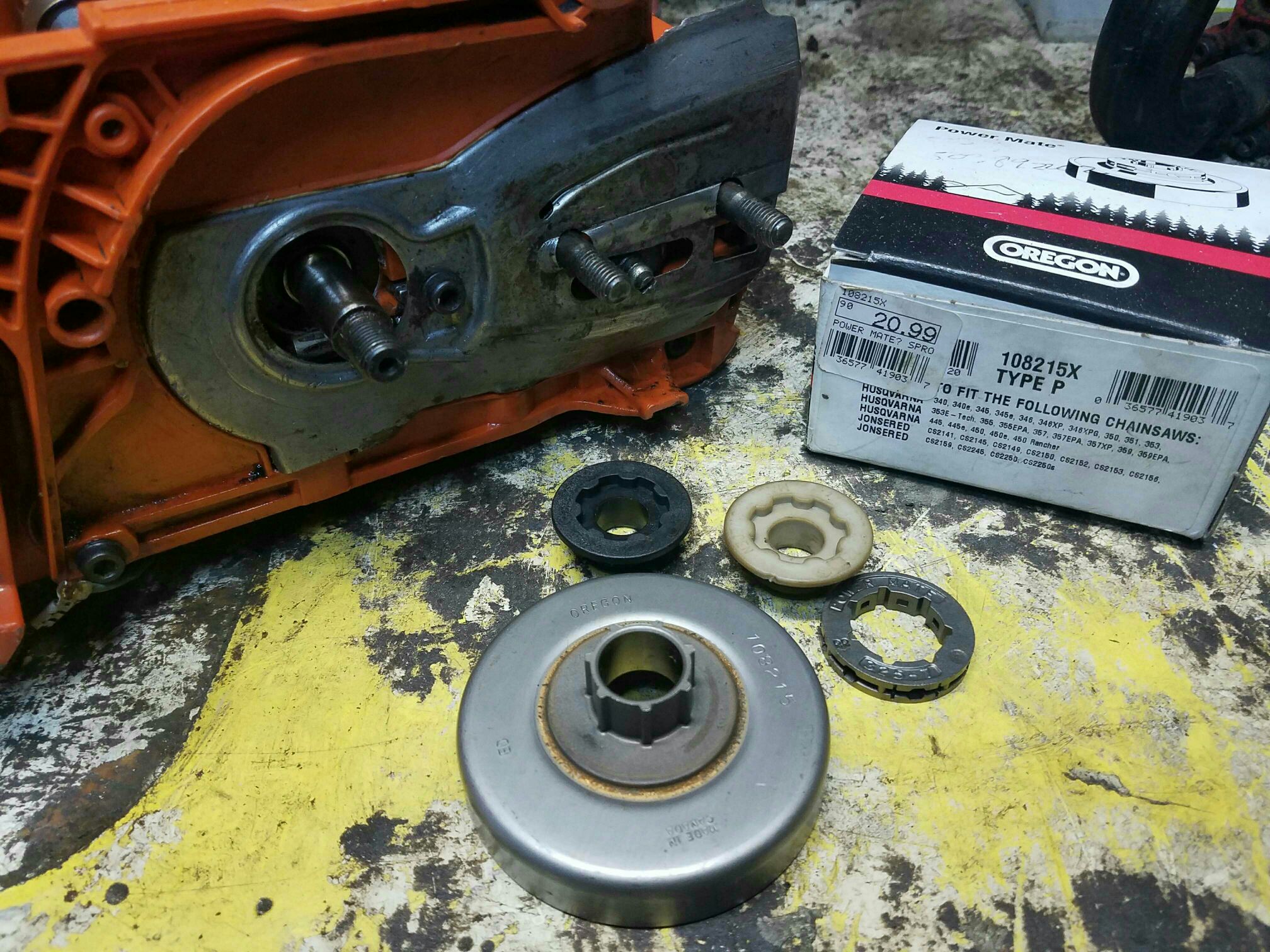

Define "it doesn't fit right"
Yes I get the different cranks...you are correct there for sure. But I don't have trouble with my rim drive. ..so I dunno what you mean.
You can cram a spline drive drum into a spur driver and it will work... but the life span is much shorter than the correct spline drive driver. I'm not tearing saws apart right now... when I build the next pair of 350s Ill show you. I haven't found a spline drive pump driver that fits a 350 crank.
There are 2 different worms. Maybe this has something to do with it

I thought the crank was the same on all those 350, same crank as used on 340&345 also.
But 350 has a different oil worm compared to 340&345

I have a 350 on the bench that I'm putting a rim sprocket and drum on. The original worm gear is not the right one for this setup. I'm assuming you would need a worm gear out of a 359?? Other then that it seems to fit just fine.

357/359 crank has diameter on 14.7mm, 350 is around 12.8mm
Spline drive driver?
The plastic oiler worm gear comes in two similar forms...one looks like a spline...the other has two notches for saws such as the 455 rancher. For the 350...you need a spline drive drum...and a spline drive worm gear. They fit perfectly. I don't know where the point of failure would or could be in that system. Yes two different cranks....but are you suggestin the clutch is set further out or in? That the drum doesn't fit over the crank? I'm not sure where exactly you are suggesting the issue is.
what numbers do your oil worm gears has?
And what dimension do the oil worm spline has?
Not sure of part numbers, but there's at least 2 worms. One has metal threads, one has plastic. The plastic one for sure works with an Oregon drum and rim
I only have one 350 project and I dont plan to build it.
Those plastic ones I've seen is 503 89 22, and they seems to fit perfect for the 346 clutch drum.
