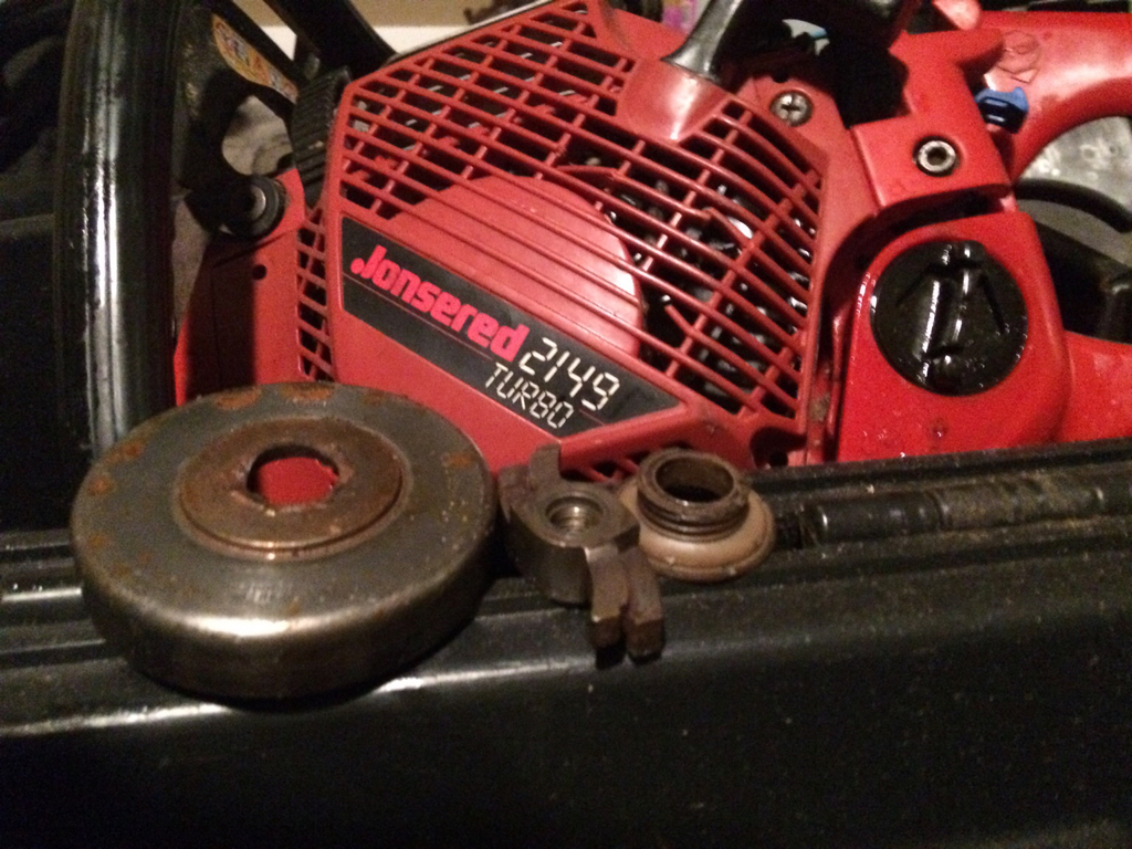

My project in this series .... how??
Splines for the rim and rim are just gone. ???
No needle cage no clutch shoes or springs
WTF looks like I need drum and bearing
Sorry to derail
Tpagel
7:21 AM
622
785
2,287
Central IL
The crank I think is ok but someone had it apart and f Ed it up.
