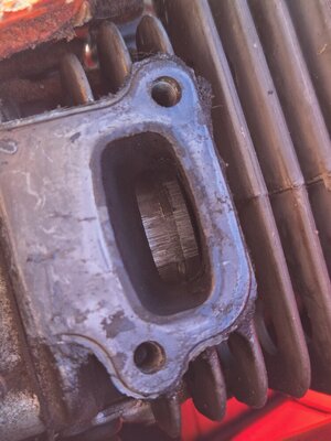

My Grandpa came over this weekend gave me a husky 350 that is too much saw for his age. Said last time he went to use it he couldn't get it to start. It doesn't seem like it has compression. Pulled the exhaust and see some scoring on the piston. Assuming the cylinder looks similar.
My question is, is this something worth fixing? Everything else is perfect. Surprised it's messed up, he is a retired engineer and pretty meticulous.

Yes, worth repairing! If you pull the cylinder off and check, you might be surprised, there might be minimal damage if any on the cylinder wall and then it would be just clean up and piston swap. Depending on the age of the saw or where/how it was stored, there might be an air leak, so might be worth pressure testing or even just replacing the oil seals as the others might be stiff and tired allowing air to pass and throwing off the mixture balance to cause the scoring.

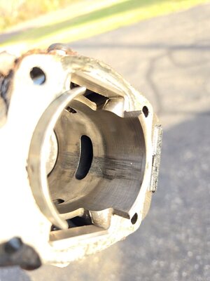

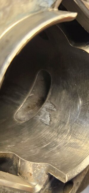

Okay, cylinder and piston are out. I think the cylinder is f'd but I defer to the experts.
It's a 45 with the dish top. This thing is dirty. Might tear down some more to clean. Fuel lines are stiff so figure I'll swap those, also figure the carb could use some sprucing up while I have it apart. Open to suggestions for an engine rebuild kit, carb kit, and whatever all I need to swap the boot clamp. Saw price was zero so I can spend a little on it.

It's always hard to tell from photos, but you might be able to salvage that cylinder.
With a saw that old, a carb kit is always a good idea, at least the gasket and diaphragm kit.

Kit the carb, use a 372 intake clamp. New fuel line. Clean up the stock jug and get a meteor piston. I had a quad port 45mm hyway jug run ok, but no telling if the next one would. Stick with OEM. As D said, you get what you pay for with the Chinese shït. Don't forget to pressure and vac test after assembly or you could be right back here in a tank or two. The sandwich below the jug has all kinds of spots for air to enter, including the cylinder risers that aren't always flat.

I’ve seen worse cylinders. Run some sandpaper over it and seem how much is aluminum transfer that comes off.
So I hit it with some 500 grit, I can definitely feel a low spot with my fingers here below, and also above, the exhaust port. Not sure if the plating chipped off or what.
