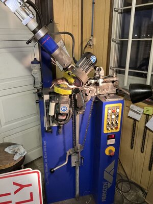

It never gets old…
Not even after 9 years.
Would be nice to see all the moving parts in motion. Kind of reminds me of a WILLY WONKA contraption only more precision.
(Y'ALL thought I was gonna say something about a sexy gal walkin')
I don’t have a YouTube account so if someone really wants a vid you can DM me and I can send it so you can post it.
I think most of us here would like to see it in action, and many of us would be willing to upload videos of it to our channels for others to see & enjoy them!

I will take a longer one next week.
Maybe Philbert could middle man an email of the longer video from you and post it to OPE for us tech challenged members.
The short one you Emailed me was a good teaser.
Needless to say I neglected to discuss this idea with @Philbert first.
PLEASE PHILBERT.
Lots of YouTube videos if you Google ‘Franzen Chainsaw Grinder’, or something similar.
Here is one from ‘Taryl’, with a sales rep that also describes some of the features:
