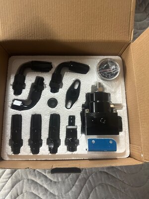

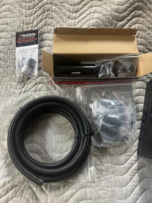

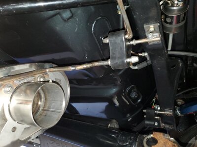

I feel your frustration with the fuel pressure regulator. I’ve tried 3 corvette style regulators. 2 cheap pos and 1 actual ac delco and none of them would keep my fuel pressure close to 60psi. Only thing I can figure is that my fuel pump just over powers them. I’m running a walbro 255lph in tank pump. My next step is basically the same as yours. I’m going to install a basic inline fuel filter and an adjustable pressure regulator under the hood. IMG_6076.jpegIMG_6077.jpeg

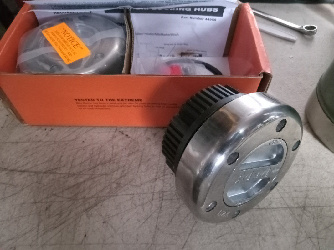

I have Mile Marker hubs on my Pathfinder. They're well-built units and function well, but after a couple of years the chrome is peeling off the bezel.

I feel your frustration with the fuel pressure regulator. I’ve tried 3 corvette style regulators. 2 cheap pos and 1 actual ac delco and none of them would keep my fuel pressure close to 60psi. Only thing I can figure is that my fuel pump just over powers them. I’m running a walbro 255lph in tank pump. My next step is basically the same as yours. I’m going to install a basic inline fuel filter and an adjustable pressure regulator under the hood. View attachment 458745View attachment 458746
I ordered the Lowdollar pressure sensor too.
I heard a few guys saying they had some accuracy issues, but they were all turbo or supercharged applications with high HP. A few psi can make problems for them I'd imagine.

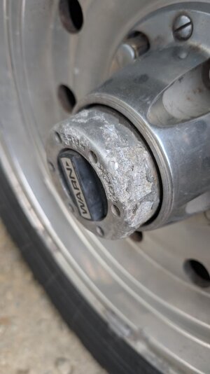

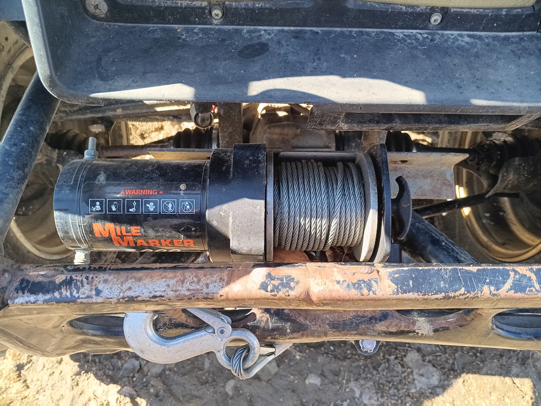

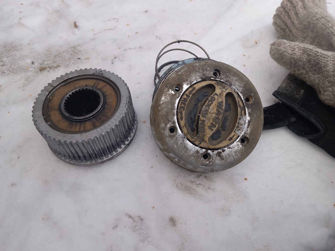

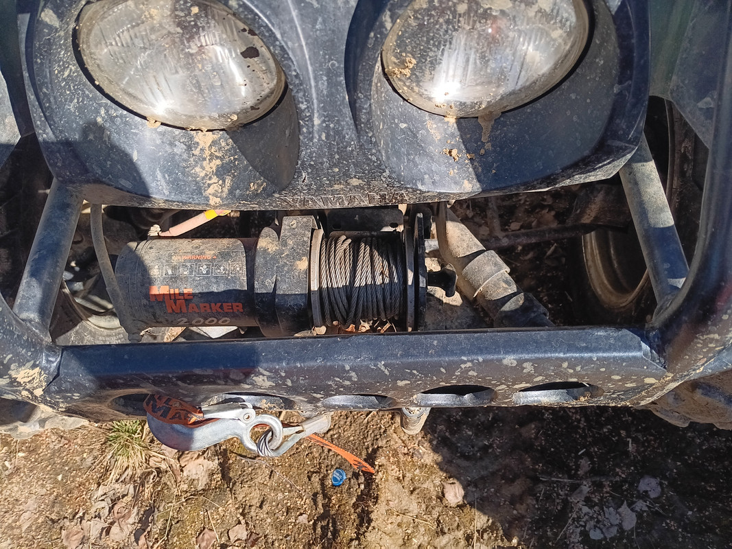

3 year old warn. Not impressed.
Had a Warn china drill winch that broke at the Chuck. Where it snapped, the grain Looked just like that cast pot metal.
Warn is like my Dewalt tools: everybody knows the name and the sht is overpriced.
Pulled coupla dead Warns off my 2 yamayeahhahas. Piss poor waterproofing of internals. I live on a river, so that warn-walmart stuff ain't cutting it.
Mile markered that sht:

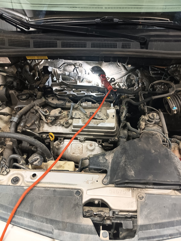

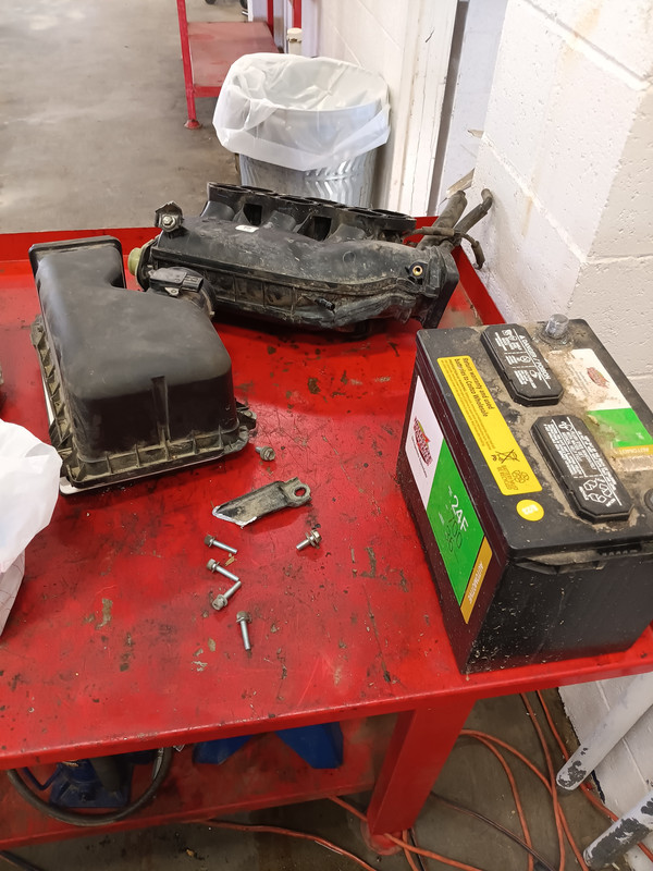

330,000 miles sienna . Misfire on cylinder number 1. Compression good. Since tranverse and against the firewall, will run 3 new coils on the firewall bank, new plugs whole way round, and replace cylinder 1 injector.
Always weird going from working truck diesels to carby mercan iron to chainsaws, atvs, snowmobiles to a Japanese road warrior.
