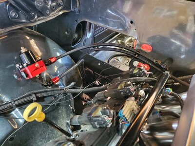

The regulator came with a guage that I'll install for now. Once I get the pressure set, the guage will get removed, and I'll wire in the pressure sensor that will read right to the Holley ecu.
I'm plumbed back to the fuel filter. Need to drop the tank and run my lines to there yet.
Also going to cut the filler neck to install a piece of hose as it will help the angle when filling.
The filler in the bumper, plus this thing being probably 2" lower than factory will make for some amusement at the fuel stations.

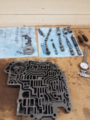

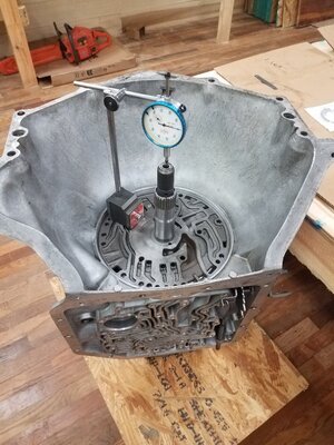

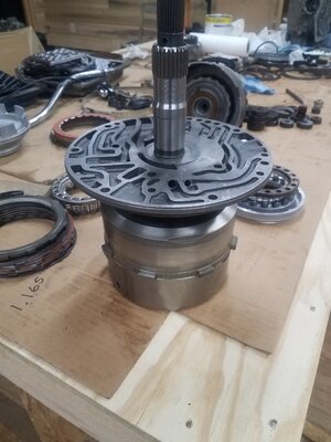

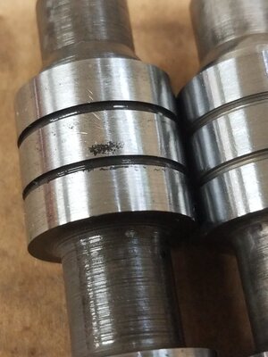

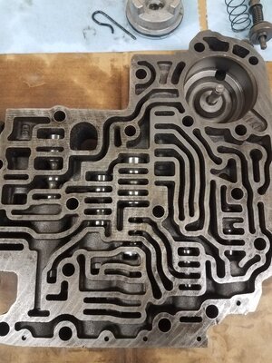

I can't even remember the last time I had my hands on a TH350.
Pressed in the pump bushings.....and then the input shaft was binding. Figured I must have buggered em up, so I cut those out, checked the bore....pressed in another set. Same thing. Ended up honing the bushings to fit the shaft. Never have had that before.

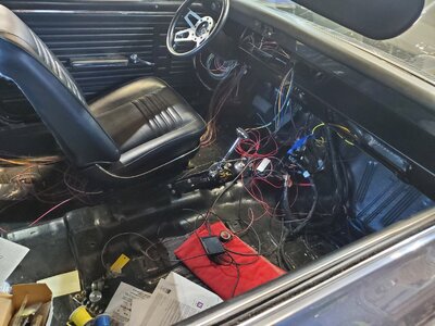

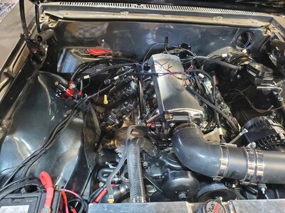

I did a quick "stretch" of the fuel pressure sensor connector wiring.
This thing is still a mess of wires that need to be addressed..
I dialed in my fuel pressure at 58psi. Set the same pressure in the ECU. It still needs a bunch of tuning but it runs much better.

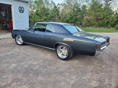

I actually drove it down my driveway! Front is way too low. Going to order some Global West suspension spring spacers. I'm going with 9/16" height ones which should give me 1 1/8" lift. Tires rub the fenders when turning
