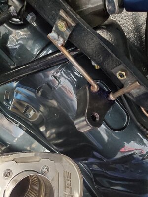

Took me longer than expected, but when I'm not working on a hoist it definitely slows me down..
I've approached the age getting up off the floor is slower.
But, other than removing once again for paint, I did get the chassis side of my muffler hangers made.

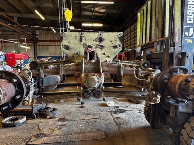

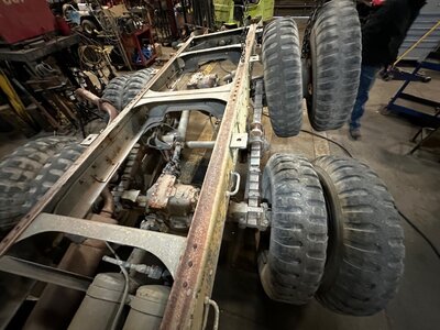

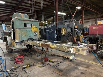

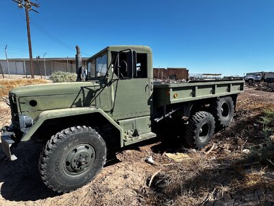

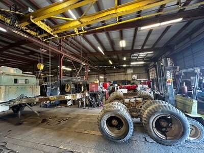

@chiselbit turning a 6x6 into a 4x4.
My brother is gonna use the rear axles and suspension we removed to make his F800 a 6x6.
Showing some flex. The rear suspension on these works very well. Front too actually.
Donor Rear axle needs work so hovercraft for now
Gotta shorten the frame about 3’

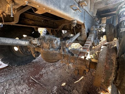

We took the drums brakes etc off my brother’s axles because he is going to convert to discs. Had to blow eleventy billion rivets out to get the backing plates off the axles. Big air chisel FTW.
You can kinda see the suspension here. The center of the spring teeter totters and locates the axles side to side. 3 link dog bones from center to each axle. Achilles heel is the dog bones are vulcanized rubber ends and the rubber eventually dries up and they fall off 😳🤦🏻‍♂️. You can buy all steel spherical bearing ends and press in but it’s a big job and not cheap, 12 of them. I have an idea to make the existing ends into “Johnny joints”.

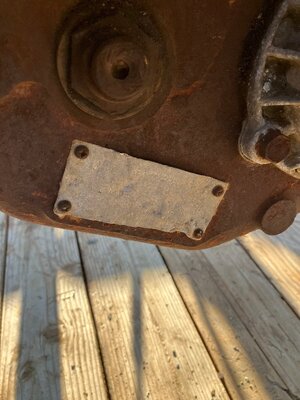

My youngest brother was finally able to pick up his 4x4 frame, turns out I was off by less than a month on my estimate of the year but it's an important month. 73-77.5 frames were the same width as 67-72, but the wheelbase was 2 inches longer. So, I'm gonna help him relocate the rear spring perches two inches further inboard so the rear tires will be centered in the rear wheel wells. He got a good t-case with the chassis but the trans is probably seized.
Plus, I had him snag something for me while he was there. It needs a full overhaul and a tube straightened, but for the price I think I did all right. This kingpin 60 outta be tough enough to withstand the Cummins. It's currently set up as a dually, my rear axle is off a dually, dually Cummins highboy maybe? Or I'll convert to standard hubs. We'll see.
