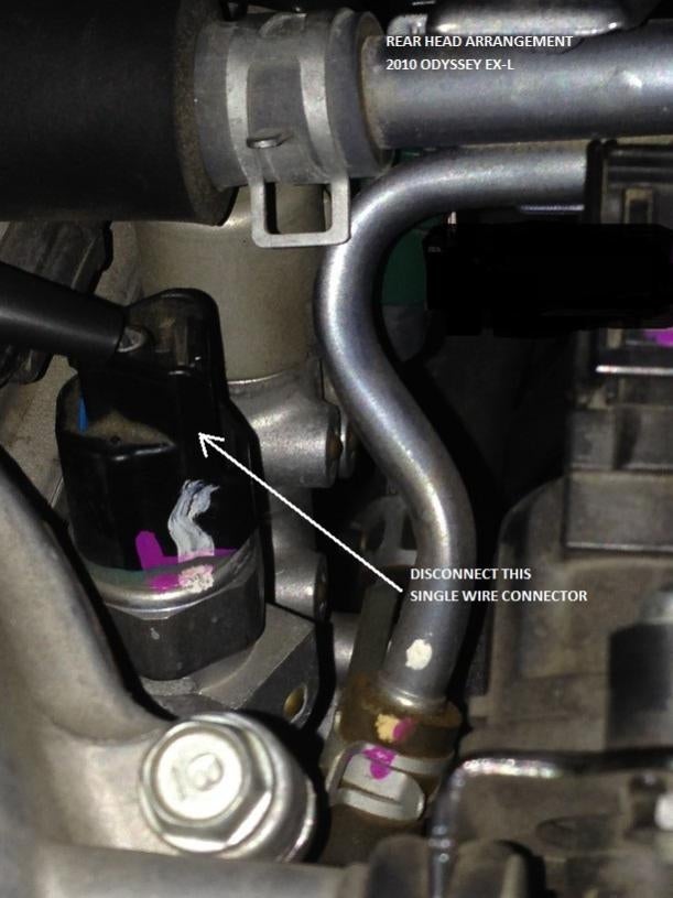

Our 2008 Honda Odyssey has started into the usual random multiple cylinder misfires caused by the VCM system. This has to be the worst idea ever, not even early 80's Mopar could have created it. Turn the engine into an unbalanced three cylinder and try to hide it with $800 fancy motor mounts and playing white noise through the stereo. There is an entire industry of gadgets for disabling VCM. Anyhow, I found a super easy way to get rid of it. Unplug two single wire connectors on the VTEC spool valves as shown in this thread from the Odyssey forum. Damn thing runs great now and I DGAF about the CEL being on. Fuel mileage actually seems a little bit better in fact!

It's really the best system on the market as far as reliability. With it I was able to achieve 29mpg on the highway and keep it above 24mpg in normal mixed driving. That was on both our 2011 and 2015 odysseys. The spool valves are the only real failure points on them. Those single wire oil pressure sensors can fail too and are super easy to replace. Make sure your valve lash is good. That is very important for this system to work properly. Keep in mind your engine mounts are 15 years old and most likely worn or even torn or broken. Always get original engine mounts from the dealer. Does not matter what vehicle make, all aftermarket mounts are junk!

Totally respect your knowledge and point of view, but I'm keeping it disabled. I would guess it gets low 20's MPG in mixed driving which is fine with me. Honestly, I would rather have our Accord's 2.4 four banger in this van. I really don't care how fast this thing is, it's just a brat hauler.
