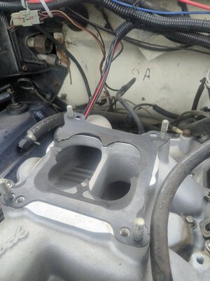

this is a edelbrock intake with the supplied gasket for a terminator efi system, look at how little meat is on the intake gasket mating surface.

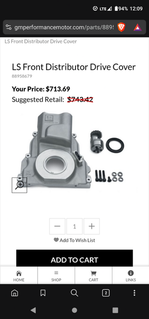

theres always this option if you have enough room up front. intake and carb
