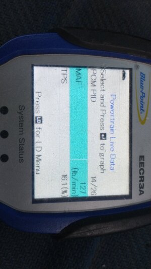

just pluged the scanner into my ls swapped squarebody and TPS is at 16.1% cold idle

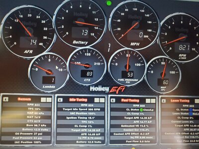

Ed, have you done a tps reset? In this pic your tps position is at 11% at idle. Iirc it should be 0-2%. If it’s above 3% you loose idle control with the iac and the system will start to pull timing and fuel to try and hit the target idle rpms
I have. I'm using drive by wire. That results in different numbers because the throttle plate itself is the IAC.
There's even a failsafe built in that any issue with the pedal or throttle body causes a no start.
The pedal and throttle body are both on the Holley approved to use list.
No matter what, the AFR goes to 36 and stays.

IAC position 100% what does that mean, is it all the way open, or is it closed all the way?
It would be nice to see battey voltage up a little higher.

IAC position is at 100% because it is not used. Default value.
