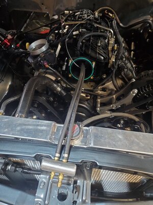

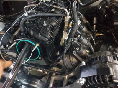

@redline4 possible if you have a bad injector dumping fuel? If left side was that much cooler could you swap the injectors from one side to the other? Might be easier than taking them out of your other truck for no reason

If it were an injector dumping fuel I'd think I'd have a misfire. It doesn't seem to have that.
The Holley ecu uses an internal map sensor. It does have a connector for a oem or aftermarket sensor. I can change that parameter and try it.
Brake booster leak was ruled out as I pulled the vacuum line and capped it at 1 point.
Scanner is nothing more than laptop and the holley terminator software.
If I take a rag, spray it with brake clean and wrap it around the 02 sensor my AFR changes. I can pull off the right side exhaust and weld in a sensor bung as I have extras.
At this point I really think I need to smoke this thing. We were supposed to go for a ride on the bike with my parents today but it's raining and not appearing to stop so maybe I'll run to work and bring the unit home.

does your dealership have the ability to disable VATs on a factory computer?
will the car start if you unplug stuff like the IAC or
coolant temp sensor.

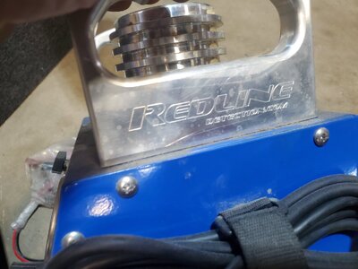

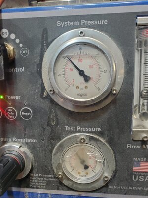

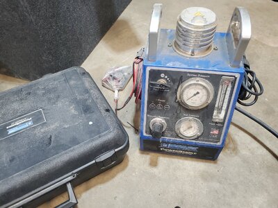

smoking it would be a good thing to do, rule out any vacum leaks.
i dont use my swapped squarebody very much, so if you did wanna try a factory harness I could pull the confuser and mail it to ya if you think itll help ya, not sure it would do much tho if youve put a cam in yours.
