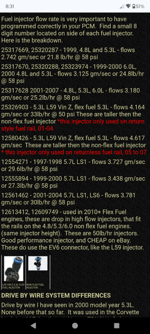

I know you have already been over it 1000 times and probably know more than any of us providing ideas but. Fuel pressure could still be a thing worth rechecking one more time? Was that motor originally flex fuel? I think they like 48psi fuel pressure instead of 58
The part number injectors I have are rated at 60psi

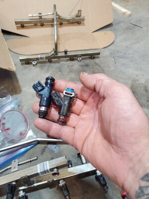

I'm just going to order 8 new injectors for an 07 Tahoe that the engine came from tomorrow.
I was under the impression that if the connectors were the same the injectors were cross compatable if used as a set.
Guess I was wrong.

One might be a flex fuel injector? And maybe the flow rate is different. The lt1 swap guy has quite a bit of info on injectors and psi and flow rate.

Injectors did the thing. Runs like a different engine. AFR is now where it should be and I can begin actually tuning it.
