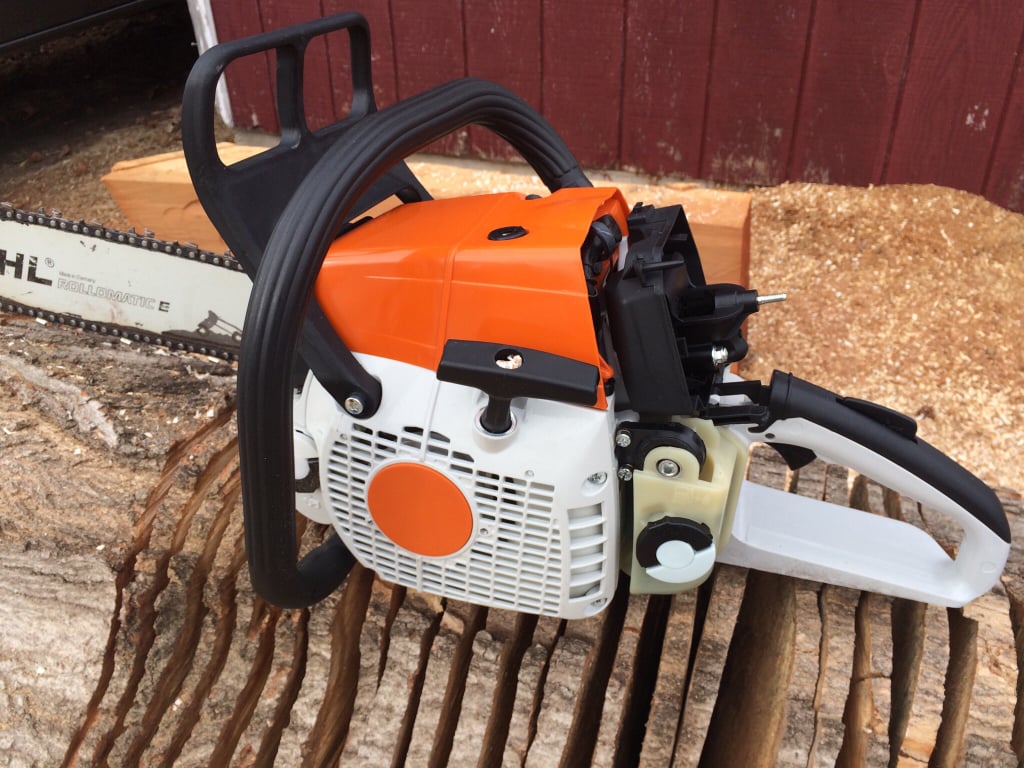

My Farmertec 361 #2 runs and cuts.
Needs further tinkering.

Farmertec 361 #2 flywheel nut left, Stihl nut right.
I suppose one could use a 1/4" flat washer but I happen to have the flange nut left over.
Go back an change my 361 #1 I will.
crazy part is they also have the flanged nuts, but I had to order three times before they sent me the right thing
I get the feeling most of the time that nobody there has ever run, seen or built a chainsaw :)
