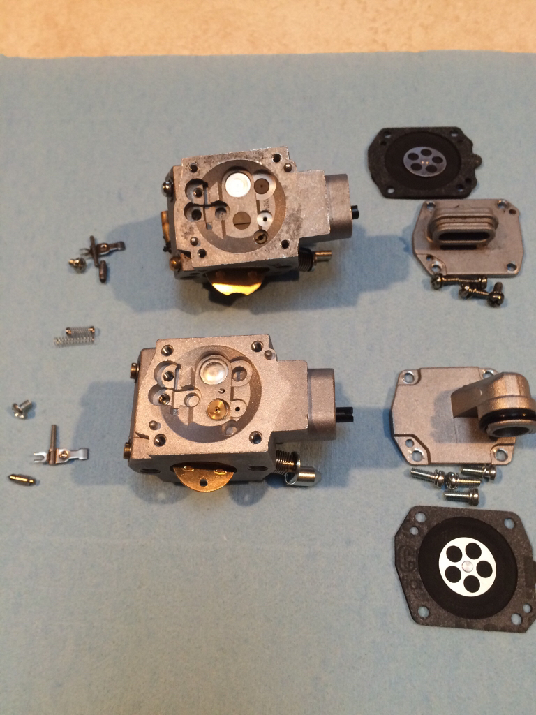

An 044 Carb is an easy swap.
I have a Walbro HD17A leftover from something or another. Throtttle bore is .807" dia. Farmertec carb is .749" dia.
Raise the WOT free speed it would.:Laie_22mini:
I'd have to swap the choke and throttle shafts to make the controls work. And, the metering chamber cover.

Walbro HD17A top, Farmertec 361 offering bottom.
The cover machine screws have different pitch and length.
Metering lever spring is 1/8" longer free length. Lots more preload on the needle valve.[emoji15]
Reassembled the Farmertec with the shorter spring.
After we get it running we will try swapping choke and throttle shafts to use the larger bore Walbro.
