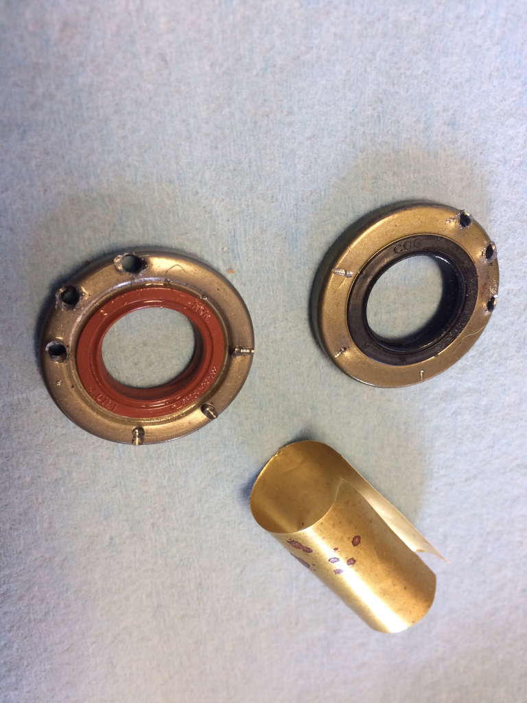

The 361's have a groove for a snap ring (?) that will roll out the seal lips.
I've done that twice.
Two above I had to remove.
A sleeve of .003" brass shim stock will prevent that.
Third time was the charm.[emoji849]
Nice! Electrical tape works as a sleeve, too. Grease and patience help lol.

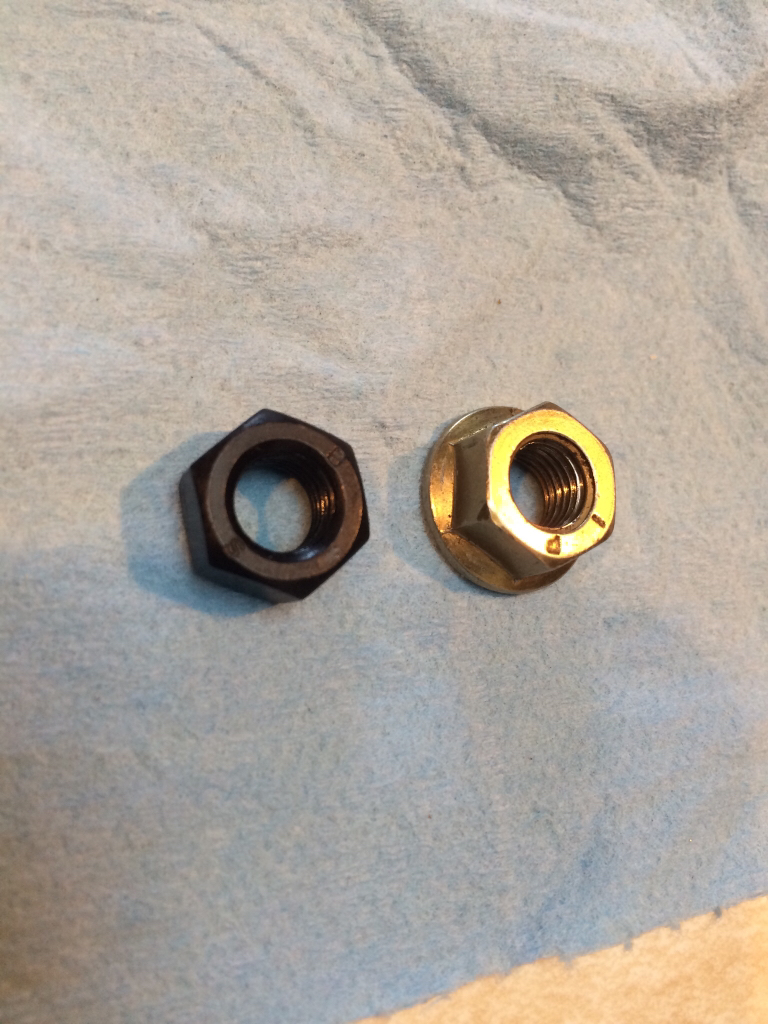

Not going to do any more as the lack of quality control by Farmertec sucks. For replacement parts they are serviceable but as a package just too many shortfalls.
Last kit has no bar nuts! Really!
Brake band drags on the clutch drum.
No 5mm x 25mm cylinder bolts.
Supplied a 12mm wrist pin. It takes a 11mm.[emoji35]
Wrong type flywheel nut. Needs to be a flange nut.
