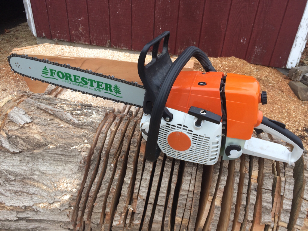

Farmertec 361 #1 runs and cuts good but the tune is all over the place.
Hope to take it to Iowa spring GTG and encourage the troops to flog it like a rented mule.[emoji106]

Looks good did you do the spring swap in the carb.
67L36Driver
5:49 AM
596
9,671
41,636
Yeah, that's the one. 361 #1.
My first ever encounter with a MS361.
I've had plenty of experience with the older Stihl models but not the newish ones.
I plan on trying the carb on the second one as is after I give the guts a look.
67L36Driver
5:49 AM
596
9,671
41,636
The 361's have a groove for a snap ring (?) that will roll out the seal lips.
I've done that twice.
Two above I had to remove.
A sleeve of .003" brass shim stock will prevent that.
Third time was the charm.[emoji849]
