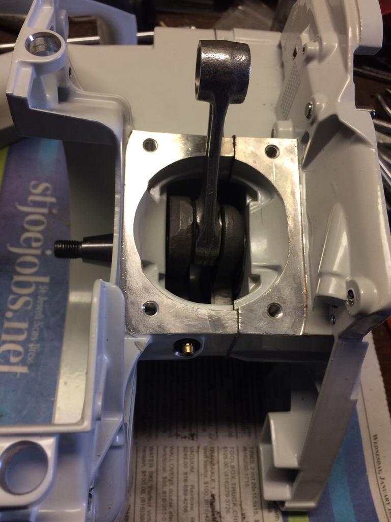

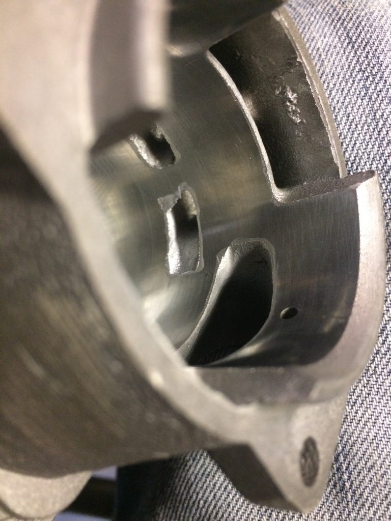

A few issues with my first 361 build:

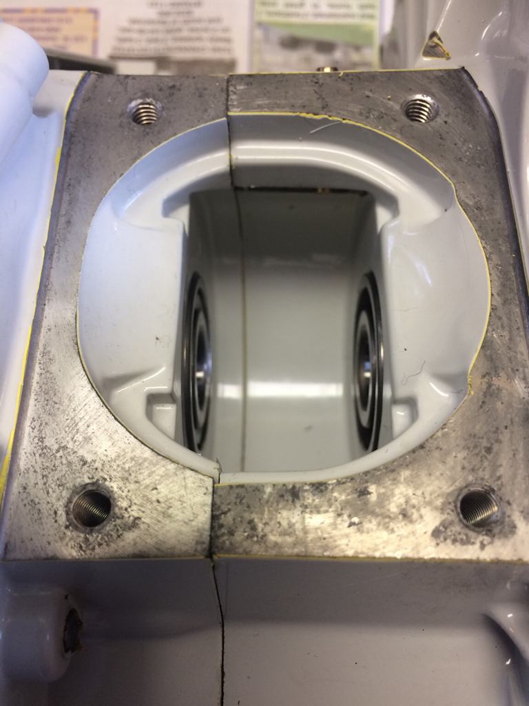

Crappy cylinder casting:
Corrosion on the machined surfaces like they sat in a damp environment:

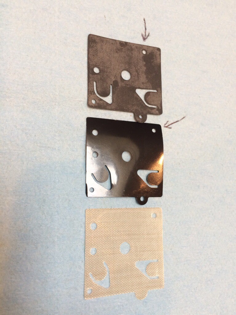

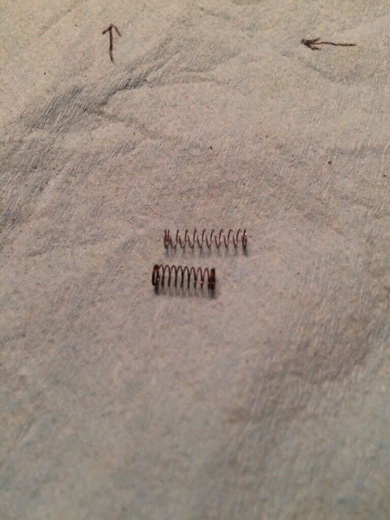

Carb wouldn't pass fuel until I replaced the pump diaphragm and metering lever spring:
Used a shorter spring out of a Farm Boss carb above.

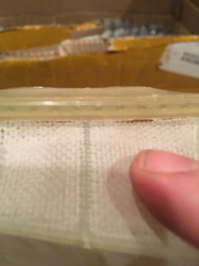

Used the top rubber fabric pump diaphragm instead of the stiff plastic. Made it fit with my leather punch.

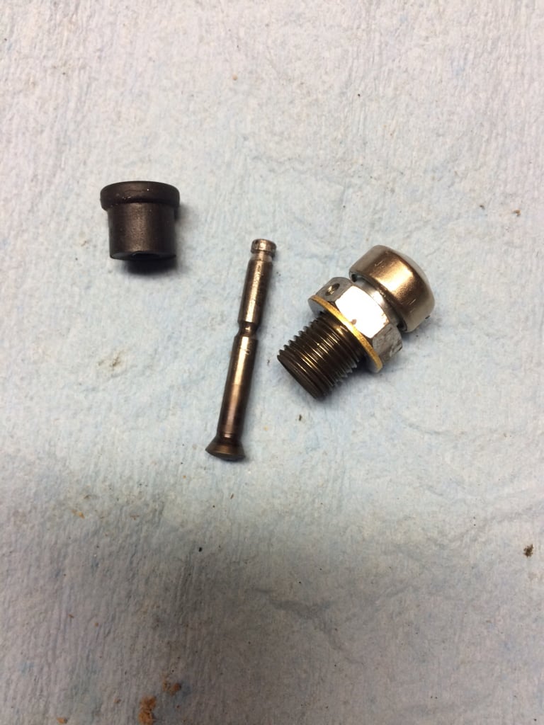

Major scare from the Farmertec decomp valve.
