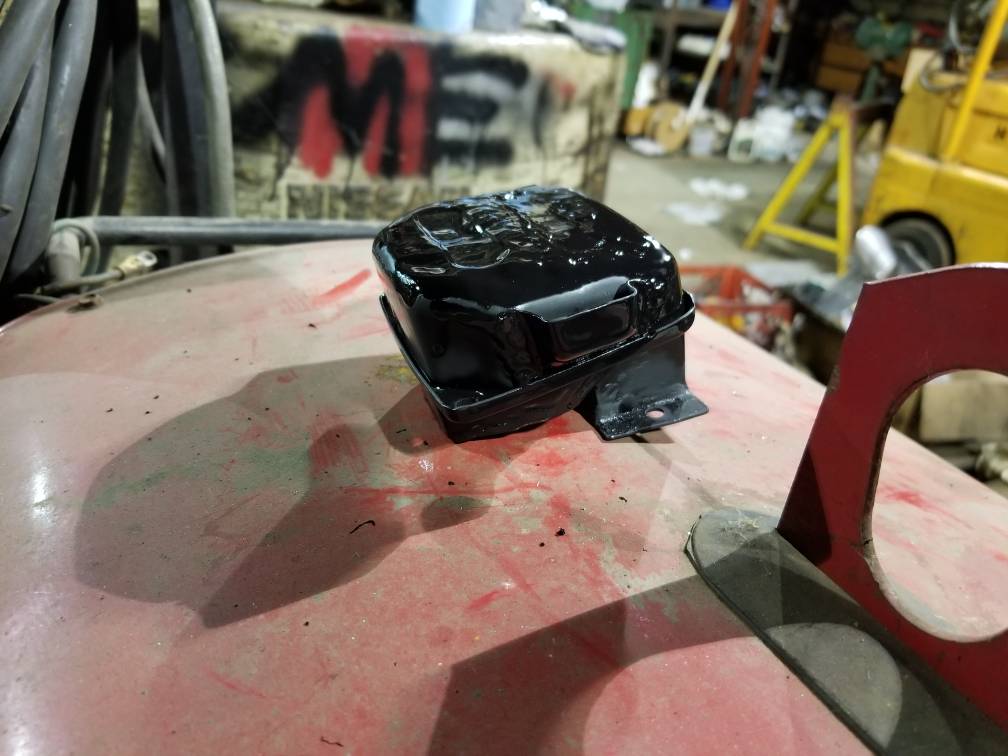

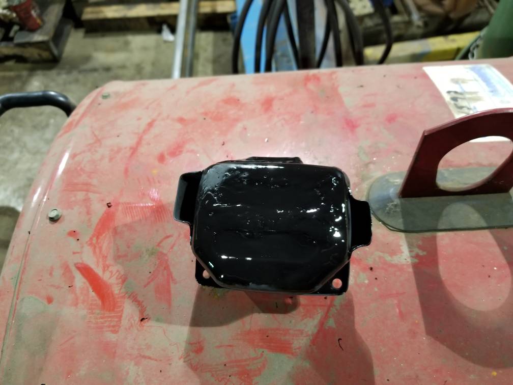

Added a small deflector on the flywheel side.
