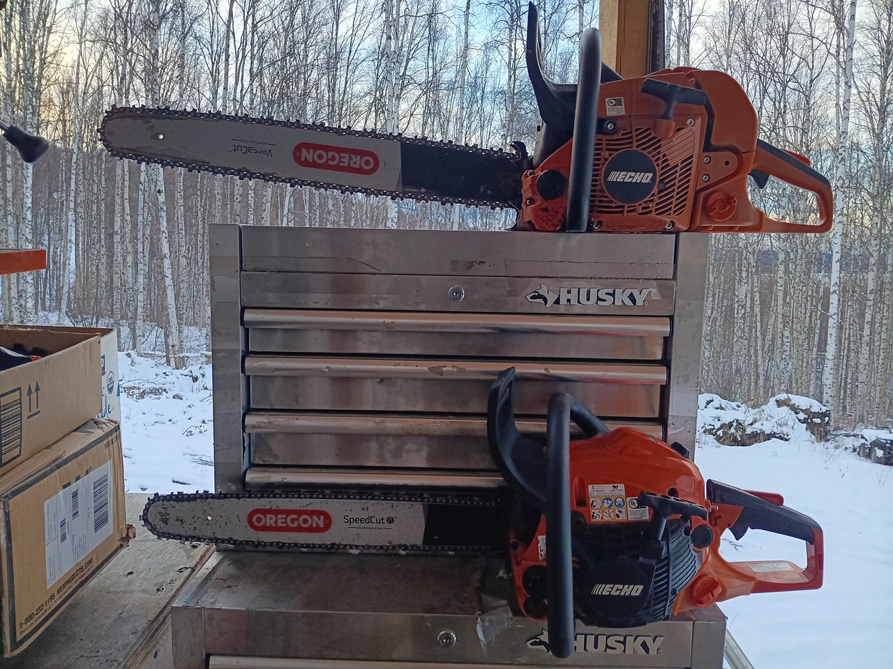

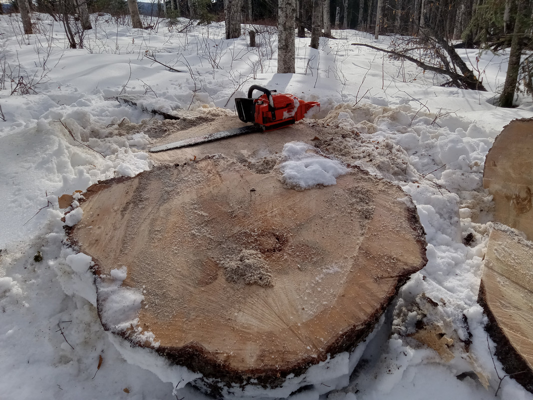

Worked my cs 590 on a half dozen paid tree jobs. I use the 590 interchangeably with a 620pw.
Here's how to set up one properly:
1. Replace fuel nozzle (eliminates "go-rich" governor)
Walbro part# 86-578-1
2. Add clutch side felling spike
echo part # 99988802100
3. Advance ignition with only .015 off flywheel key and no more.
4. Delete base gasket
5. Open up muffler.
As configured, they tune up at 13100 rpms and have 170 psi. Squish is around .040 with base gasket delete.
As configured, still not as fast as a 620. I've put a tach on both. 620 cuts about 300-400 rpms faster in the cut. In certain instances, makes a difference on a paid job. Also, becuase of the slower rpms, the oiler output on the 590 isn't as good as the 620. I had to max out the oiler, whereas my 620 is bout 1/4 turn less oil output.
I've also owned an ms 311 and an ms 310. I did like both saws until the time came to work on the things. Neither saw had the freak of nature, low end torque of the mighty 590.
