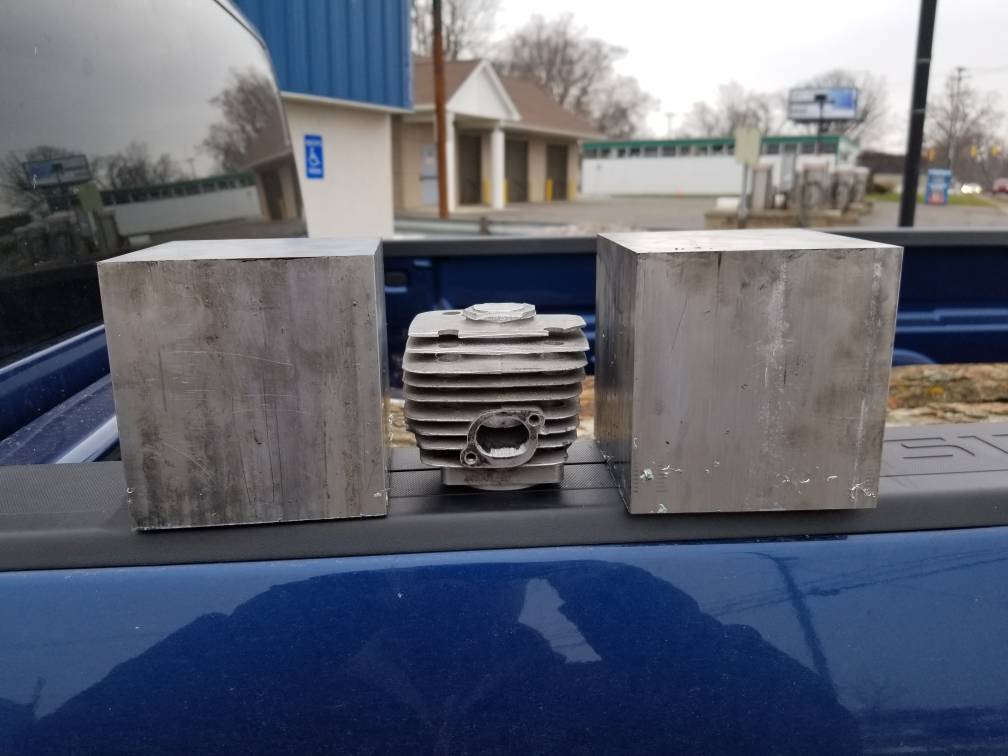

Not sure when any progress will be made, but I got the blocks to get started..
that should keep ya otta trouble for awhile. did you order the sleeve?
Or get me into trouble.
It's just a chainsaw, don't gotta get me into space. Lol
Thinking bottom fed quad port dolmar 7910 style.
Red97
9:56 PM
385
Jan 2, 2016
7,497
54,168
MI
  1. Wtf you going to do make your own jug?
That's the goal.
Wider/longer exhaust port, no spacer needed. Same on the intake side.
Make it a bottom fed quad port. With a cast iron liner.
Still have the fins and angle plug. Just no spacers or plating.
Oh and 52mm bore.
79.8cc :)
Thats the plan anyway.
