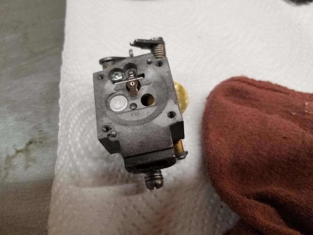

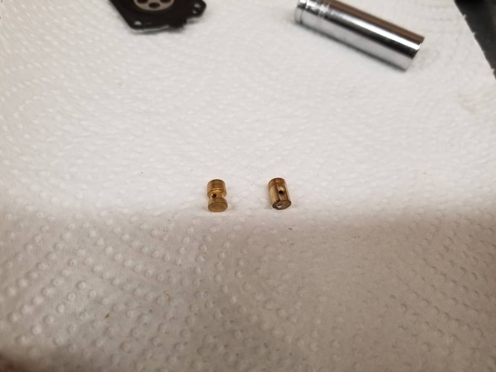

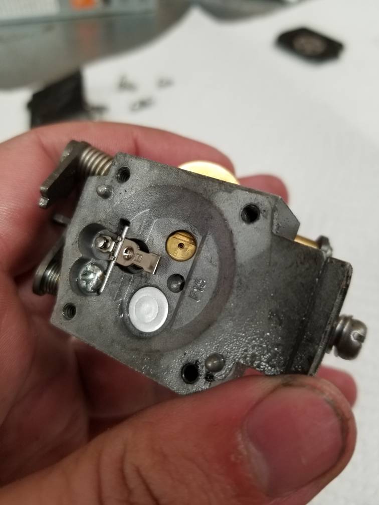

Defeated the bypass nozzle in the carb. Now it will tune out like a normal carb.
Bypass nozzle is the one with the hole in the bottom. Yes one could just plug the hole. Why not just pop it out and replace it with the correct nozzle.
Solid nozzle is on the left, stock on the right. You can see how the new nozzle has a band machine full circle, and has 2 feed holes. This allows you some wiggle room setting the depth.

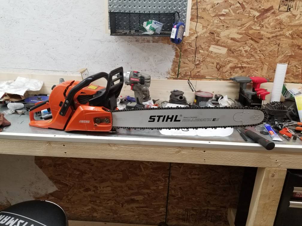

Going cutting in the am, want to see how it does with a longer bar and bigger wood. 25" 84dl 3/8.
