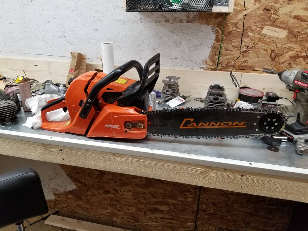

I dont think you will be disappointed by setting your ex to get some more bd.
I think it could handle 98/9 easy enough. Would rather try dropping the jug first and keep it round 101 if possible.

How it' not like your renamed it the Red97 7300.
Cuz they be jelous. Lol
Wish echo would come out with a new 70cc offering similar to the cs620.
Wow Joe that saw is straight filthy! Awesome to see the concept you been talking about run so well. Its gotta be pretty agile on that echo 60cc chassis. Truly the Echo Wizard here folks!
Thank you,it feels pretty good in the hands. I'll have to swing by and hack on that maple trunk when I get back from work.
Good one. That should have some ass with a long bar.
I picked up a tip or two here :wink:
I hope so. Shooting for a 24" bar firewood saw. With the ability to go bigger if needed.

Wish echo would come out with a new 70cc offering similar to the cs620.Thank you,it feels pretty good in the hands. I'll have to swing by and hack on that maple trunk when I get back from work.I hope so. Shooting for a 24" bar firewood saw. With the ability to go bigger if needed.
I think you nailed it!
And I have heard that they are supposed to be coming with a new 70 cc offering.

Well it made it mostly through the first tank.
Idles really well over 30min while I was on the phone lol.
Smooth while in the cut. Nice jiggle at idle.

My 362 just stepped up to 24 3/8 but skip. I had a ton of trouble with oil leaks and got that sorted. Next will be 8 pin and then full comp. It might just need the " port job" to run full comp. Yet to be seen. Everything else is done but the ports and no machine work, yet. It hums and pops a bit too.
Wanting to see yours buried in 25" oak. Lota saw there.

Got my oil leak figured out. Dawg screw was hitting the bar plate causing a bit of a gap. Now the spikes are installed no more problem.
This saw seems to have a lot of pull for what numbers the jug has. May run into clutch issues lol
