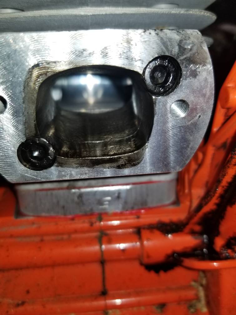

Pulled the muffler off just to check things out. Noticed a neat wave pattern on the ex floor. Checked the comp. Must have had some extra oil the first time. Surprisingly no marks on ex or intake side of the piston.
Used 40:1 saber, almost have 2 tanks through.

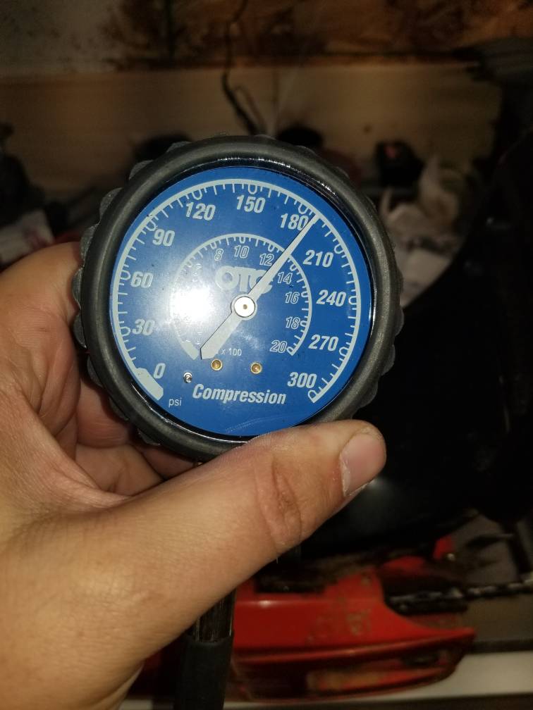

It's likely over 200psi running. Soak it with oil and repeat.
It hasn't been started in a few days and 10* when I checked. I'm sure you are probably correct.

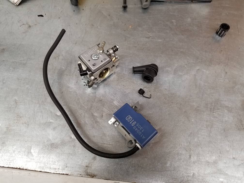

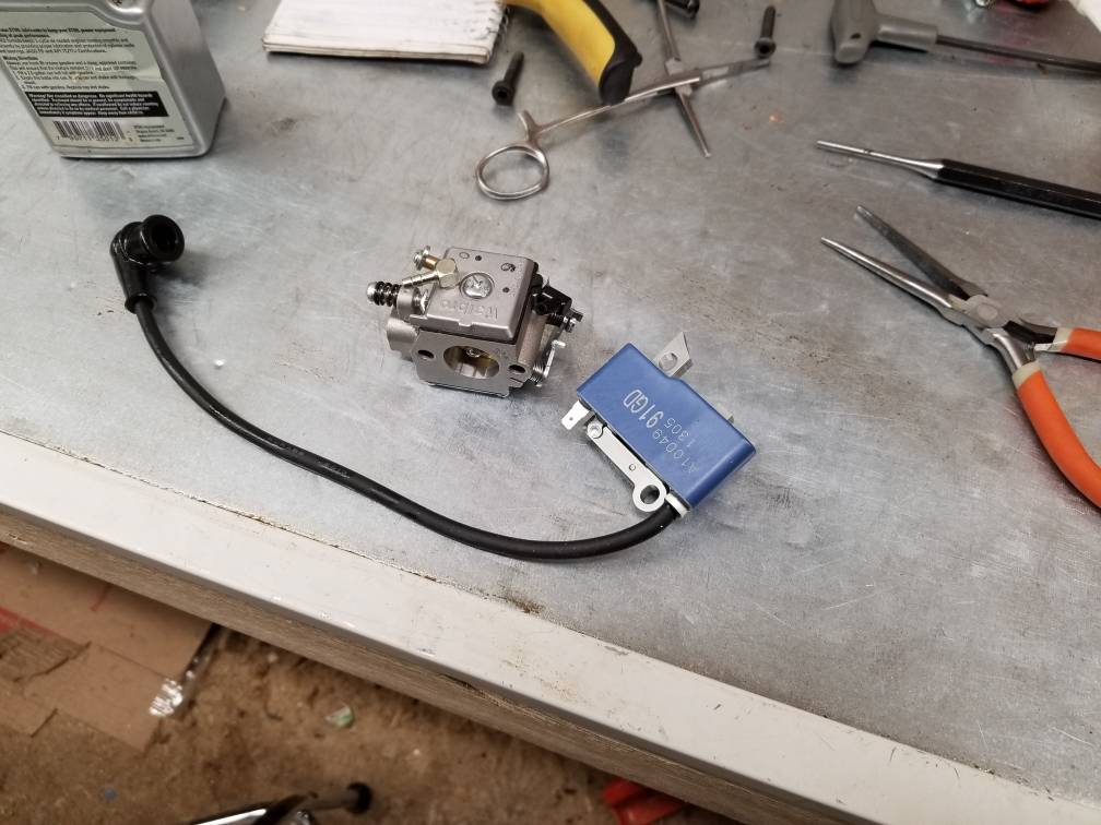

Hooray spin faster stuff. Just in time for the gtg
Before and after.
The 620 carb has the same bypass nozzle, with a slightly smaller hole. Still the same idea as the smaller carbs.
