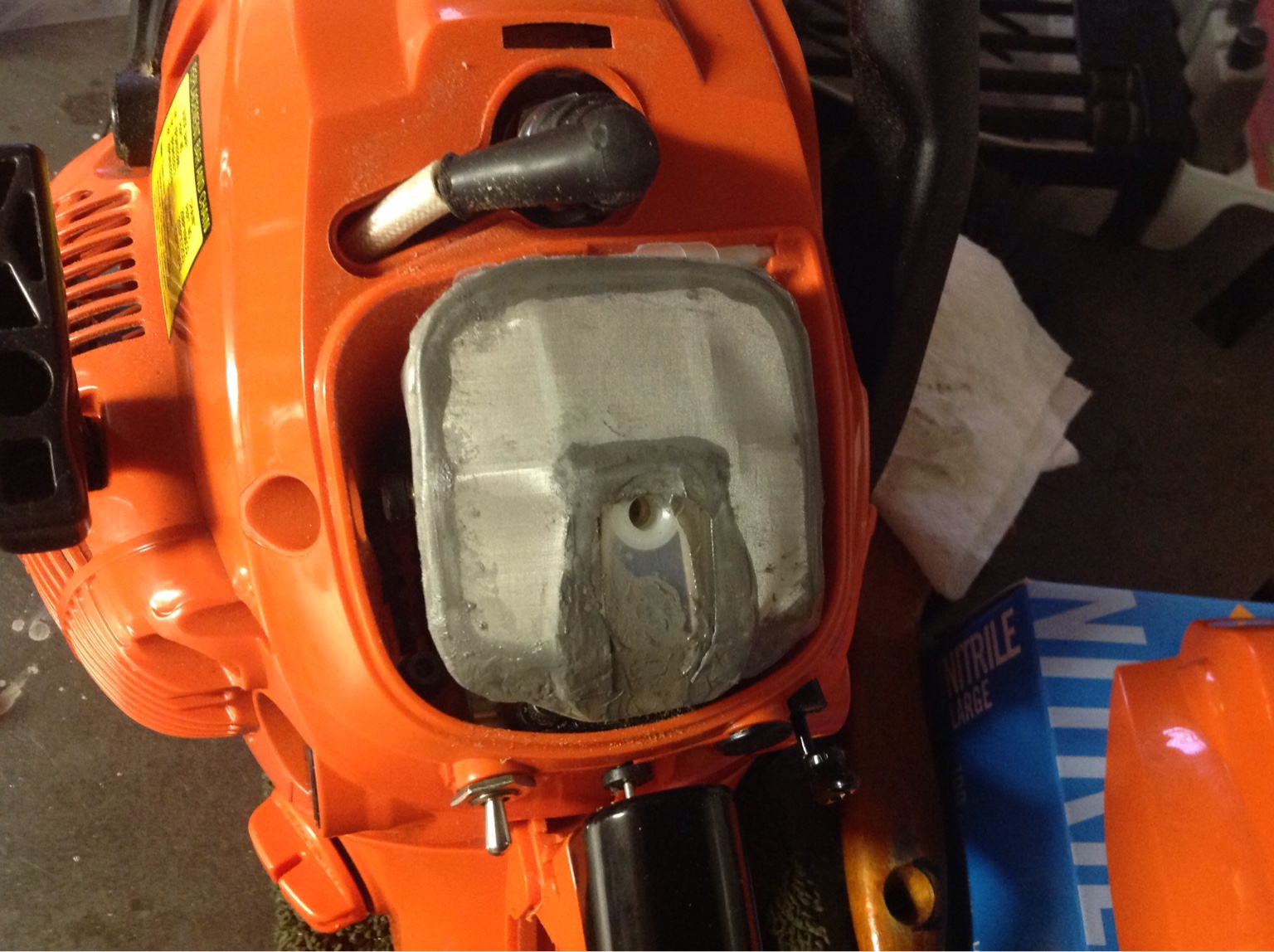

Made these for adjustable choke linkage.
These carbs come with a long choke rod. So this will allow me to clamp the link in the correct spot, and trim the rod down.
You get the idea here. Might try an come up with a high idle solution while I'm at it.
Added an impulse elbow to the top plate, used some jb to secure it in, filled my oops, as the original impulse passage in the carb body while I was at it.
