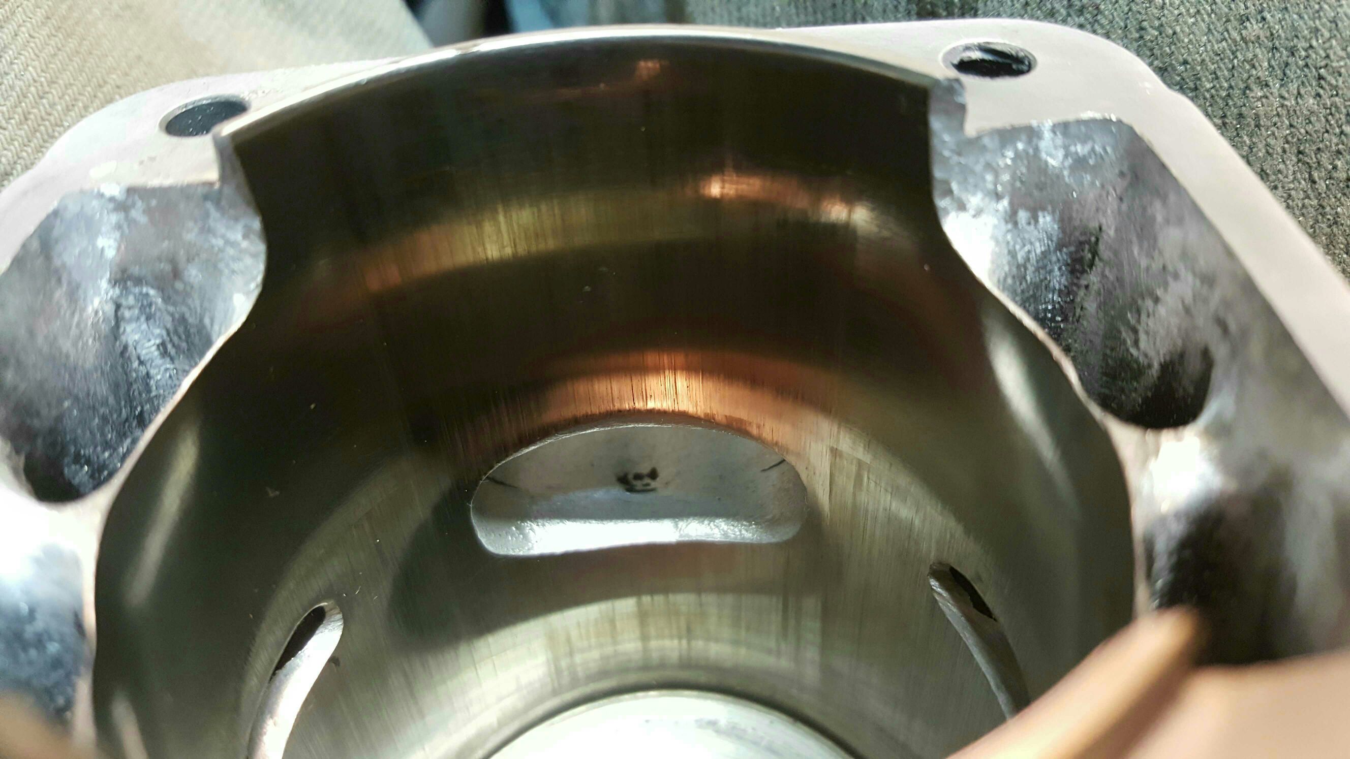

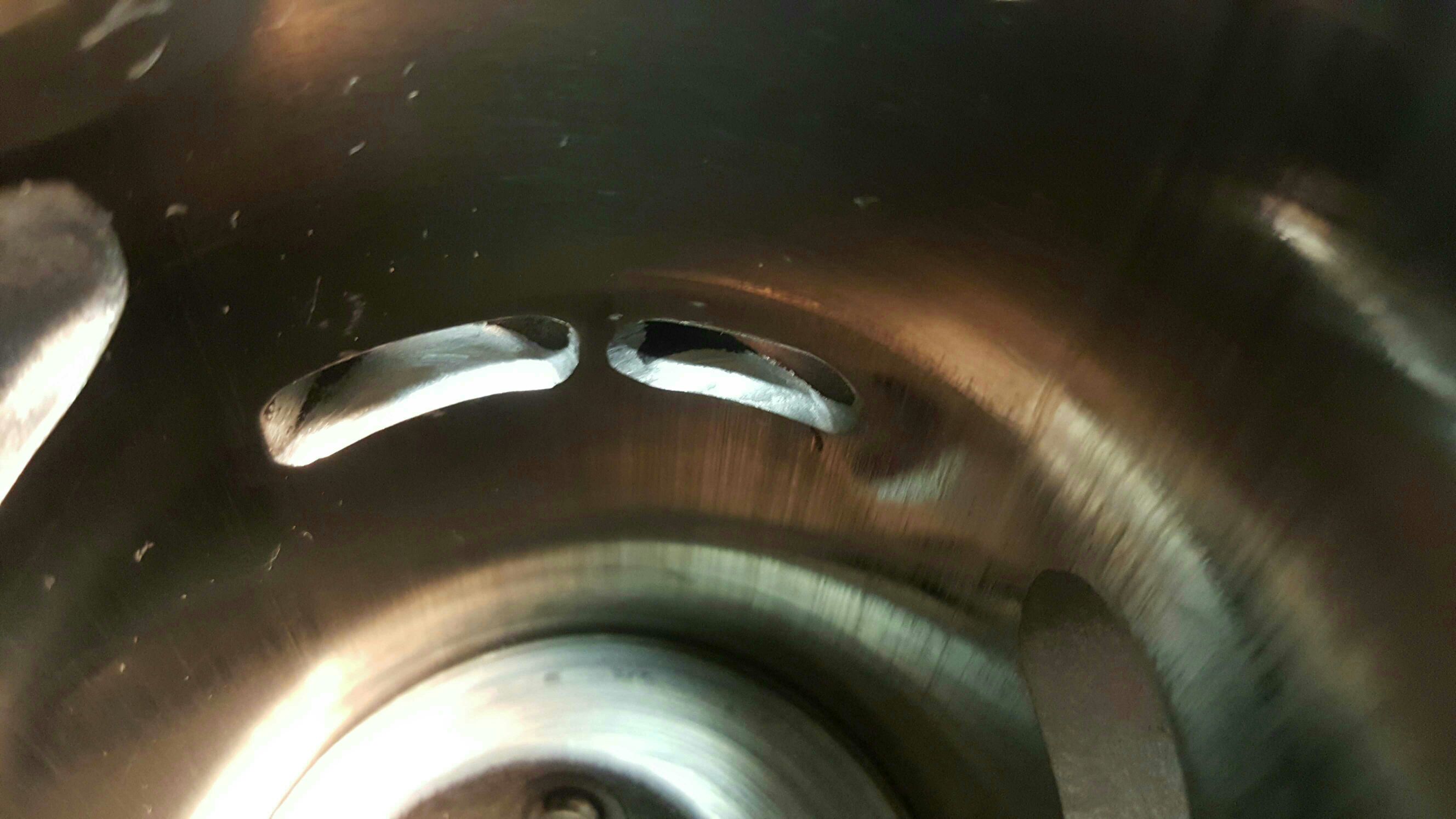

Left to right. Work on lower trans wall a little bit. Square it up kinda like my line and blend it down in.
Thin the bottom of the trans divider. Kind of point it and then blend it up into the tunnel just a little ways.

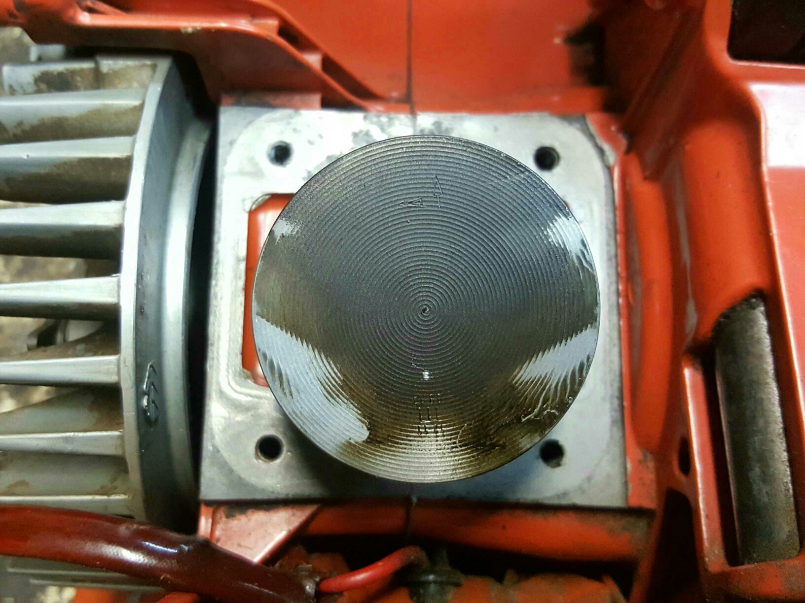

Thank you for the info. [emoji2] I spent some time laying out the ports and just looking at what I want to do. On the lower transfers I have it drawn out
almost identical to what you have there. I've learned from doing 372/365s that there's some good gains from nipping the corners and smoothing out the lower transfers.
Do I have to worry about the ring end gap coming down into the intake port if I widen and square off the intake? It looks like it stops above the port enough not to worry about it. I need to take the fuel tank and carb box off to be able to see in there a little better.

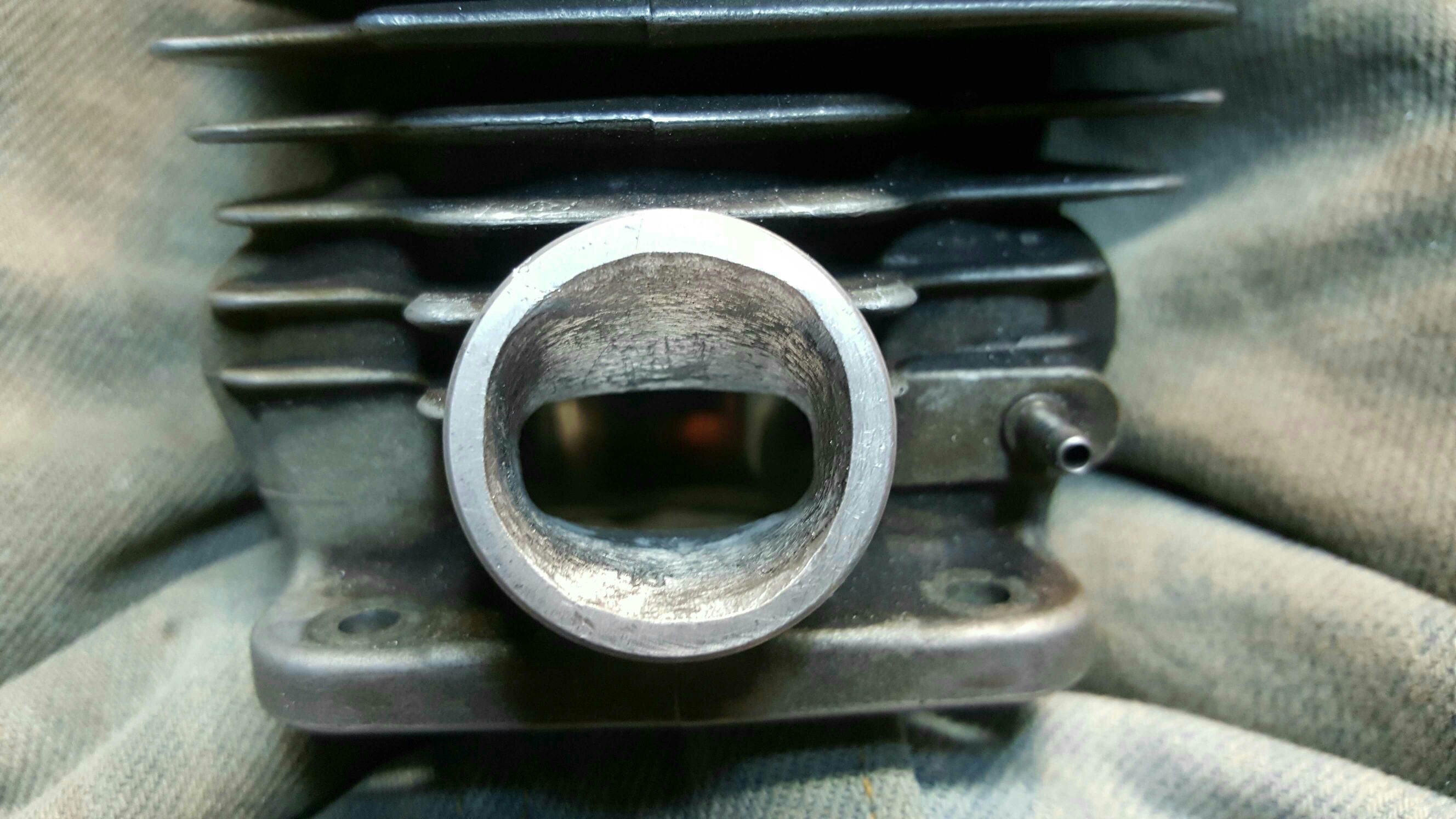

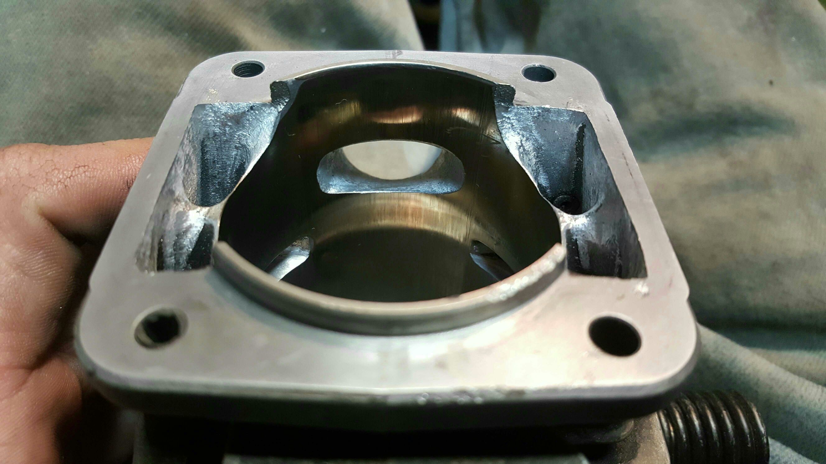

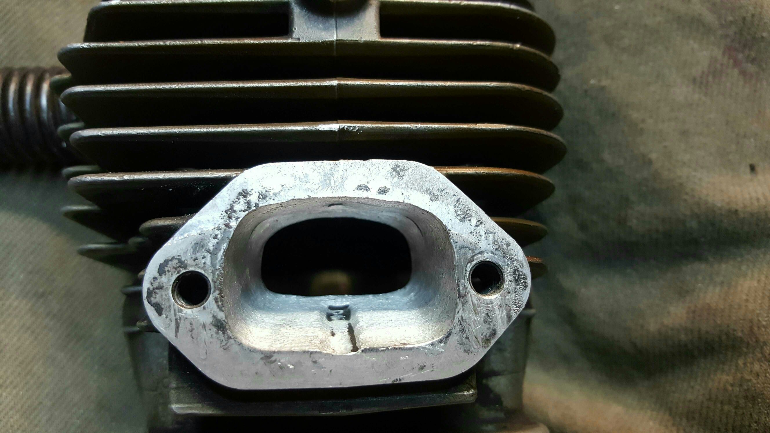

Finally got some time to do some grinding. I have everything roughed in right now. Intake got widened and raised just a tad. Case matched lower transfers. Raised exhaust and widened. Raised transfers. Timing numbers are
In. 80.5
Ex. 100
Trans 128 / 131
Still have to put bevels on. Numbers should go to ex 99. Trans 127/130.
