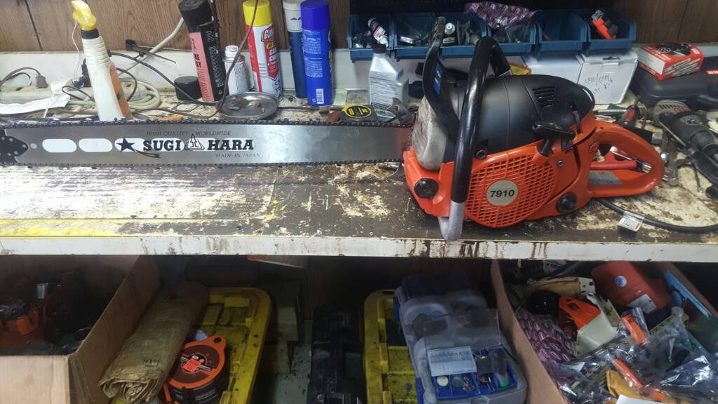

Got it all back together. I did not do anything with advancing the timing or switching coils. Wanted to see how well it runs then do the switch to unlimited coil. I'll try to upload a video. These are the first cuts with 32 inch bar.

Did the timing advance and put a second port in muffler today. Seems to have better throttle response. Much more gooder. Gonna get some more videos of it running tomorrow in the same piece of wood.
