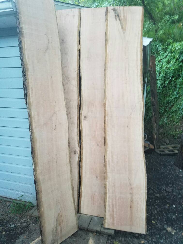

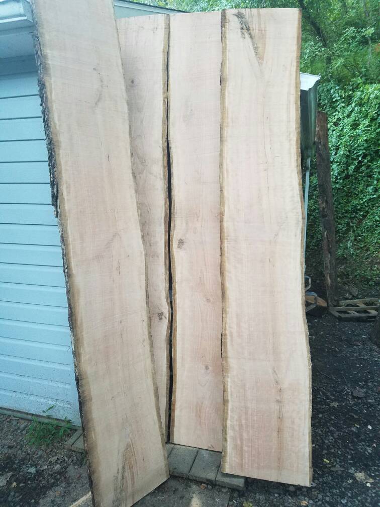

I just milled a decent sized cherry trunk tonight, about 18-20" and got 5- 8/4 slabs full width and two slabs with half rounds on the bottoms, but they are still usable. I have a 36" Granberg mill that does a great job if you set up the first cut well. Here are some shots of the slabs I milled. I typically stay on the thick side because if.you are looking to net 4/4 finished and mill to 5/4 you have a lot of waste. Nice trees that should make some great lumber. Good luck with whichever option you choose!

Good point, I guess I should figure out what type of lumber I'd like out of them first. For some reason I wasn't factoring in the board thickness adding up to additional waste, but that is a very good point. I think I'll order a grandberg 36" and mini mill and get to practicing. I've got an 084 that's been sitting on the shelf waiting for this day.
